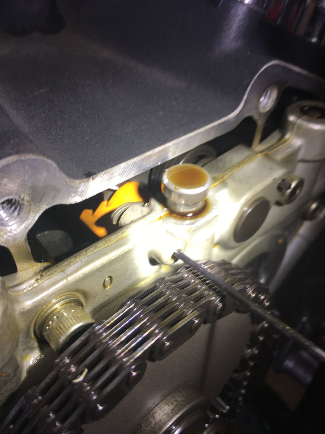

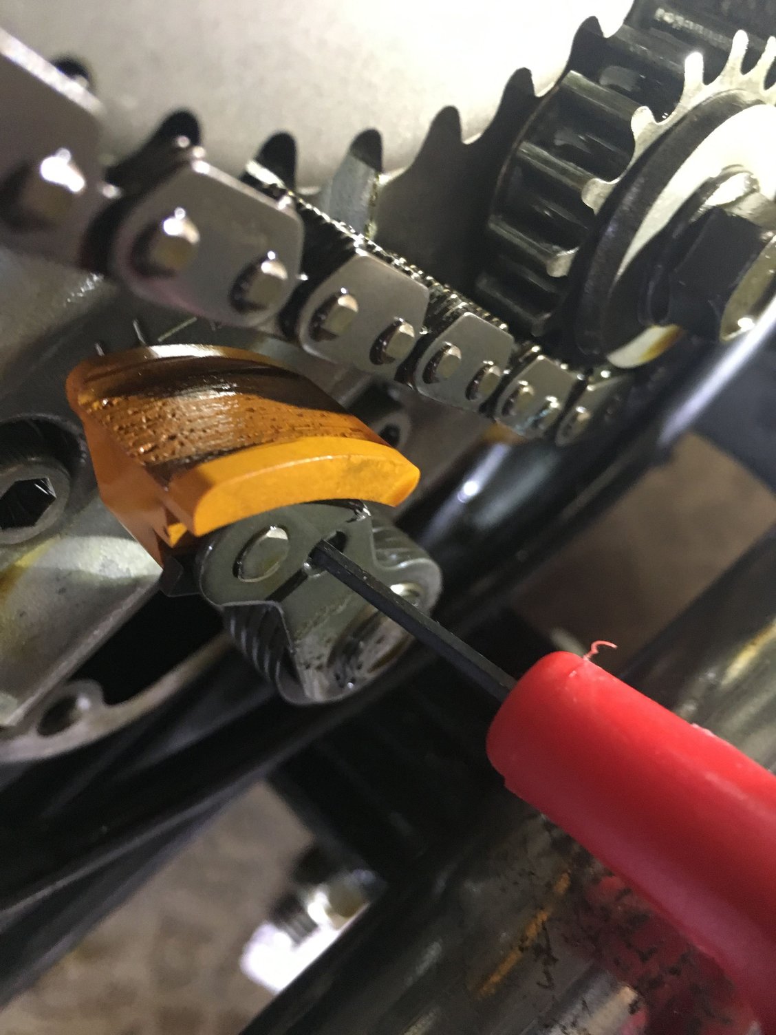

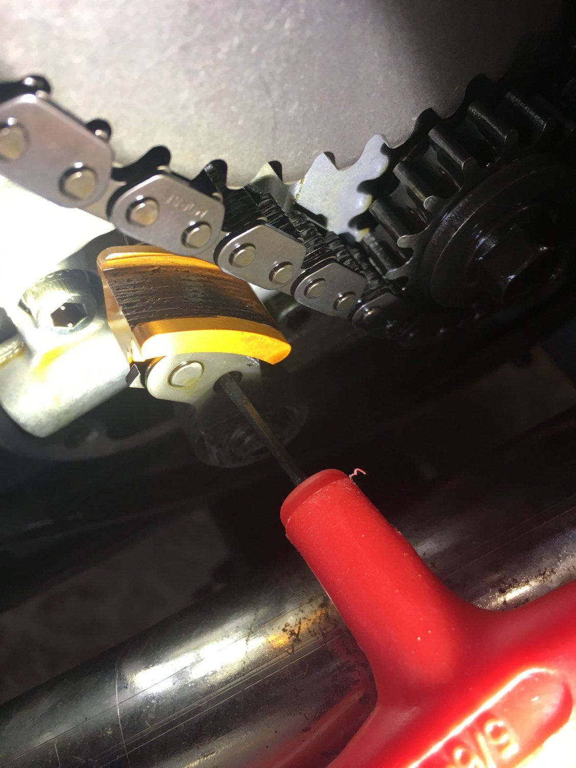

Heres a couple pics of my tensioners. The outside one needs to be replaced and not sure about inside tensioner and don't have a mirror to check it. It looks to be in one piece but I'm just gonna do them both anyways.

Good plan!! Make sure to get the "new" material pads or go with hydraulic tensioners and cam plate

Mine look pretty worn out, front one does at least. Im pulling the rocker box covers to get push rods out. Trying to keep things simple and dont mind the extra labor to save some money at this point.
