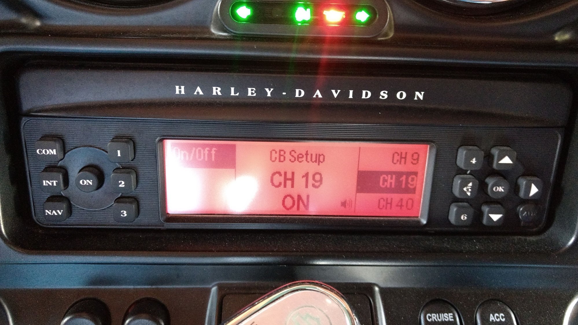

Had the outer fairing off and noticed the bike has the CB module but it dosnt show up on the radio , do you need the Mike to make this work ?

No, you should be able to select the CB with the hard button switch next to that function from the main menu. Been a while since I had the radio you have but I believe there's a button associated with the home menu. That menu should also include a selection for the Intercom as well?

I have both the CB and Ipod modules on the radio ( Stock HK ) shows
AM/FM/CD/Weather and IPOD , The CB does not show up , the bike has 2 antennas and all wiring is plugged in
I thought the CB would show up on the radio dash but it doesn't , bought the bike a couple years ago never had a headset or mike and never noticed if it ever worked , the curiosity bug strikes again

You don't need the headset or microphone to listen to the CB. The CB function should show up in the Harman Kardon radio display. To verify operation of the CB module, maybe you could swap out with a friend that has one?

Not looking at it right now, but I think it's the middle button on left of display. Also make sure your audio selector switch it's in the "all to speaker" mode or cb traffic will route to the intercom. Should be in the full down (or towards the rider) position iirc.
Edit: memory is useless apparently. Upper left button marked com.

Thanks that was it
