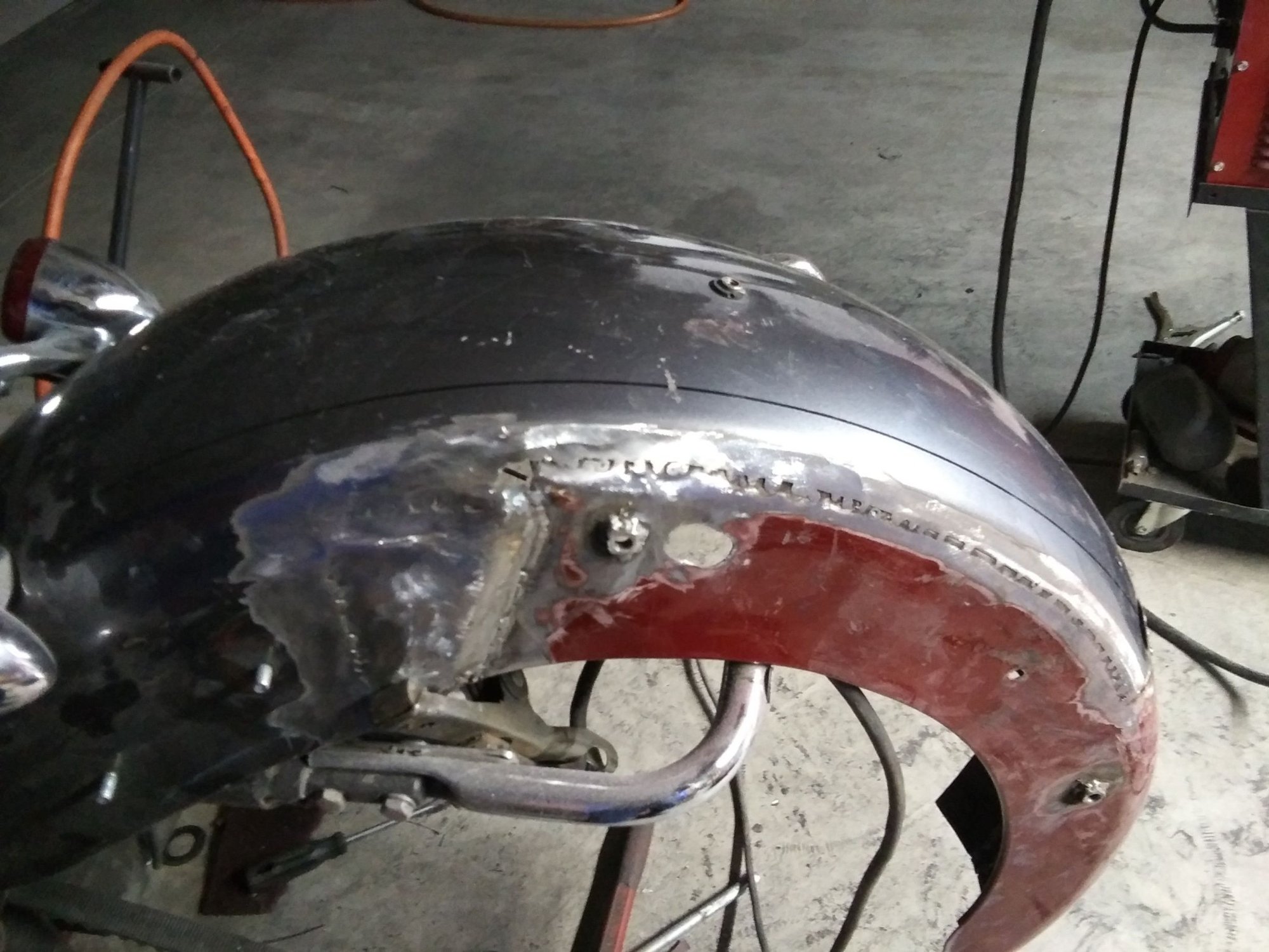

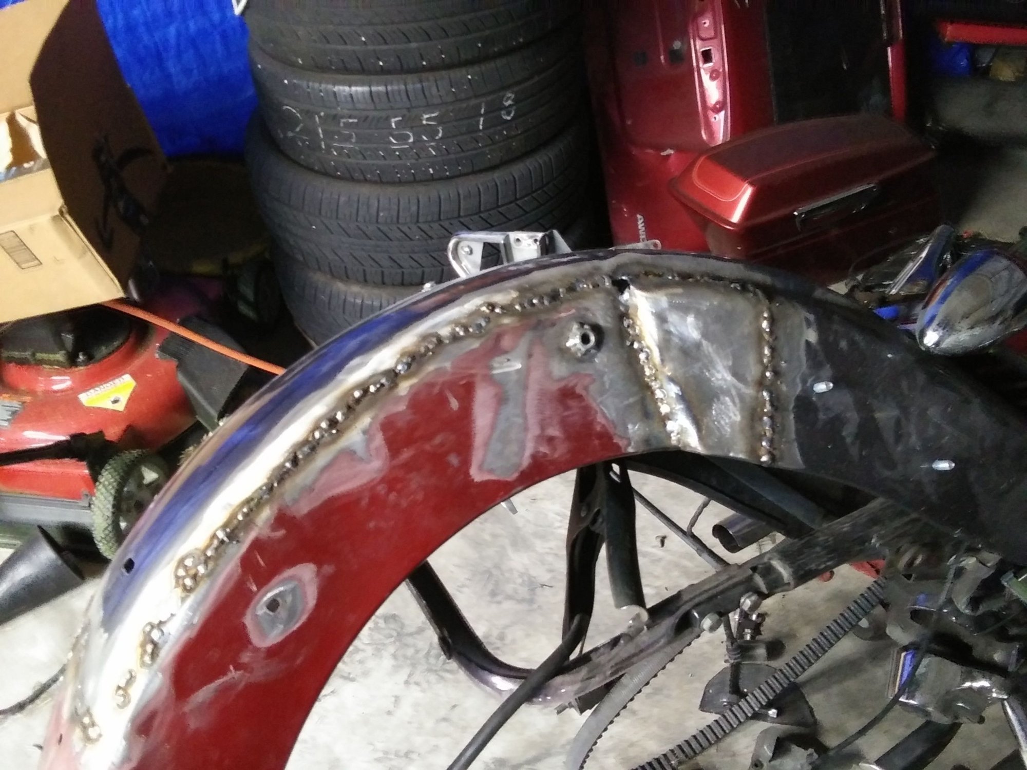

I cut the mounting & front section of the 99 fender, split it down the middle & welded it to the 14 fender while narrowing the 14 fender at the front section that mounts to the bike.
