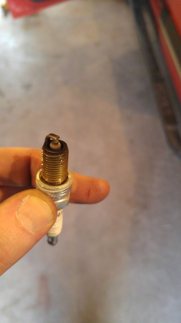

Guys I'm scratching my head with this one. 2005 Road King carb stock 88 motor. So previous owner installed some DynoJet mods and had pilot jet 48 and main 180 in a DynoJet tube it looks like. Anyways I was getting really bad carb back firing. I have an Arlen Ness open big sucker (he had a hypercharger) on before. So I cranked out the air screw 3.5 turns and that nearly eliminated that. Fast forward to now. I put some ebay megaphone on stock headers and I'm now getting really bad decel pop like really bad. It away when I pull the choke out. So ok it's a lean pilot jet....but I'm already at a 48!! Also get a bog and cut out feel in 4 and 5 gear like it's hesitations to go for a second. Tempted to put in a 50/185 combo and air screw out 2.5 turns. Next week I'm putting on a fullsac true dual kit too.

Also my mpg is horrible like 30mpg bad.....and plugs look a touch white indicating lean but can't figure this out for the life of me. Not adding up.

The 48 & 180 was what my old '02 Fatboy had & I think that was the popular combo for stage 1. Your plug looks pretty good. I've got my original Dynojet jet kit if you want to experiment I'll ship to you for $15.
