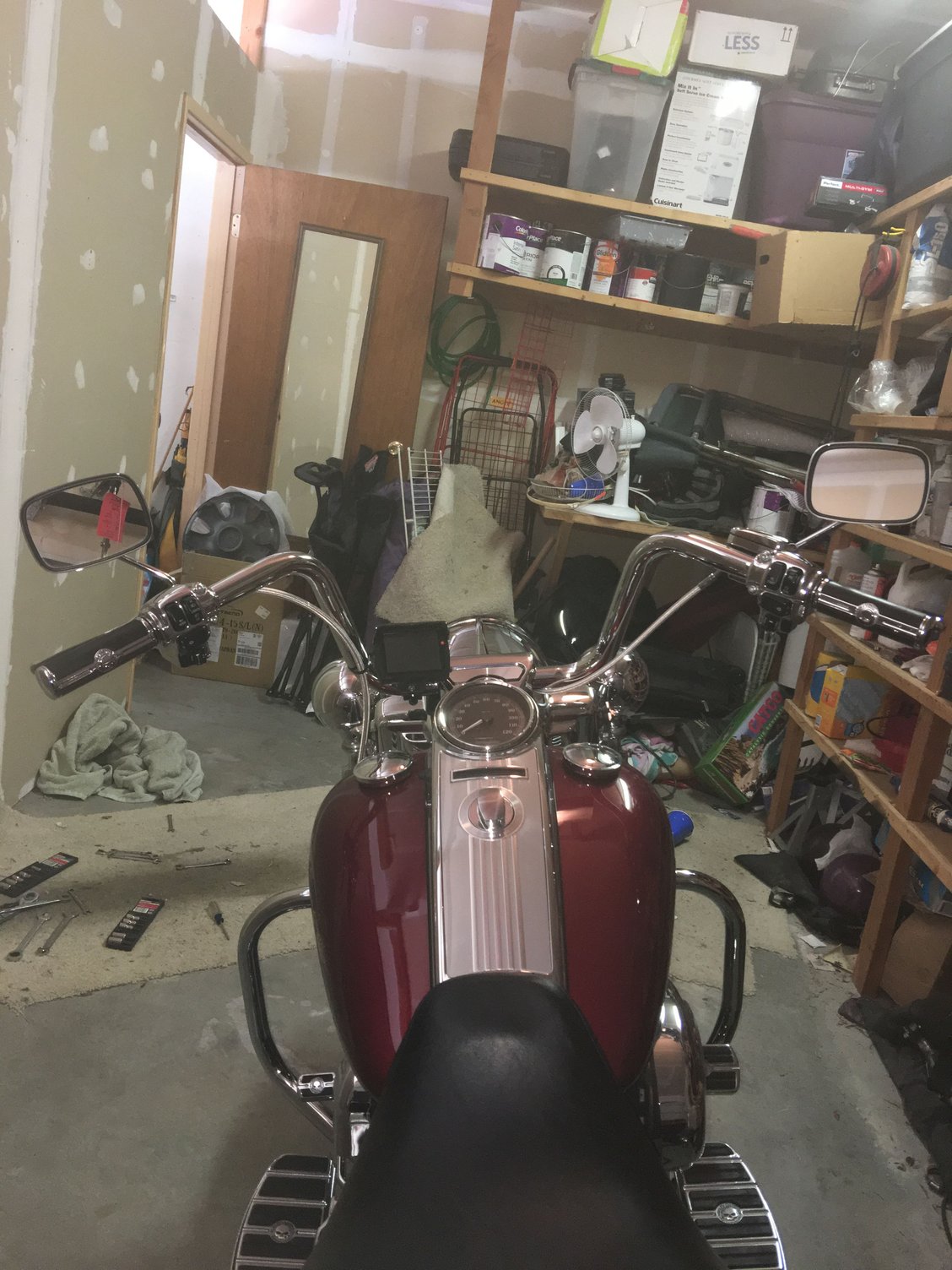

WO515's Installed
No Cable changes needed. 8" wire extensions were more than enough.
WO515's installed.

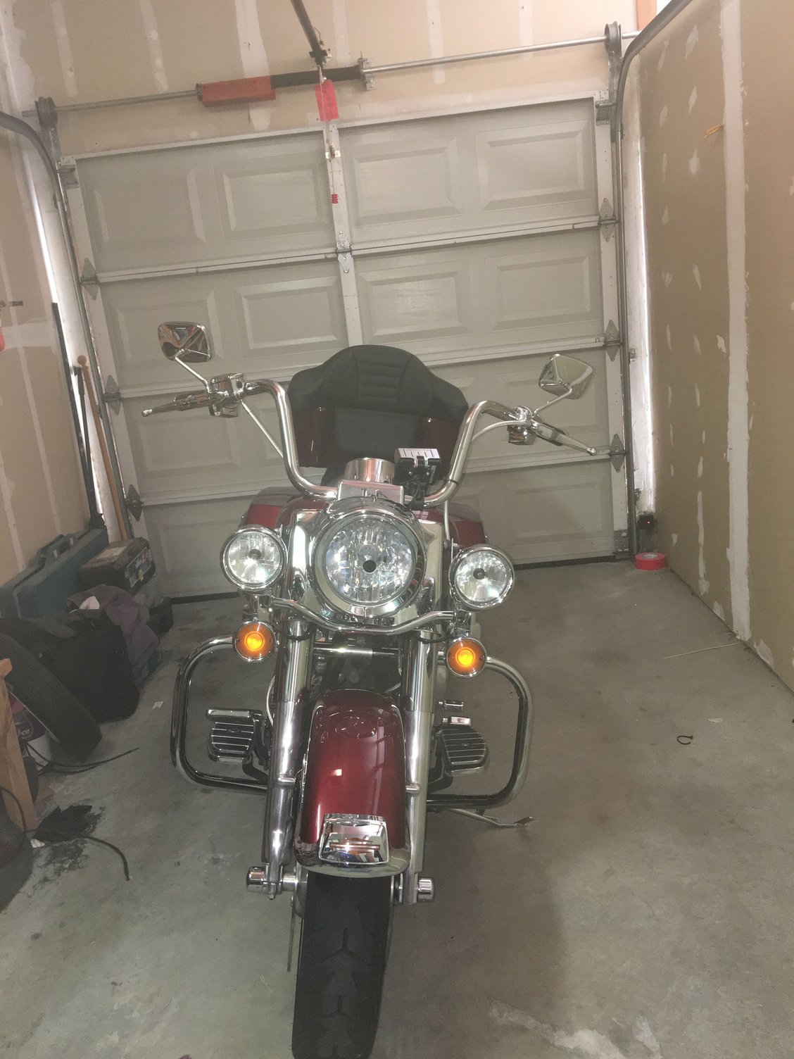

I put the 10" Chubby's on my 05 RK Custom.
The brake line will fit, I just had to bend it to fit the new bars.
Had to cut the ties under the nacelle to get more slack.
You can see part of the rubber part of the line now, that was previously hidden under the nacelle.
The clutch will also fit, but it's pretty damn tight on a full turn.
Had to reroute where it was attached to the frame, and used zip ties to keep it in place.
The throttle cables will also work, but again are pretty damn tight.
Had to change the way they were routed under the nacelle to get as much slack as I could.
The only thing I had to do was add some wire to the harness.
Tip, if you are doing this yourself,
add some extra length to the wires in case you want to go higher in the future the wires will already be done.
Total cost was $210, the bars, and some wire at the HW store.
took me 2 afternoons, but i was also adding the passing lamps, so that took a little but extra time.
here's some pics, you can see how tight the throttle cables are, but they work just fine. For $210, this is a good mod to your bike.
