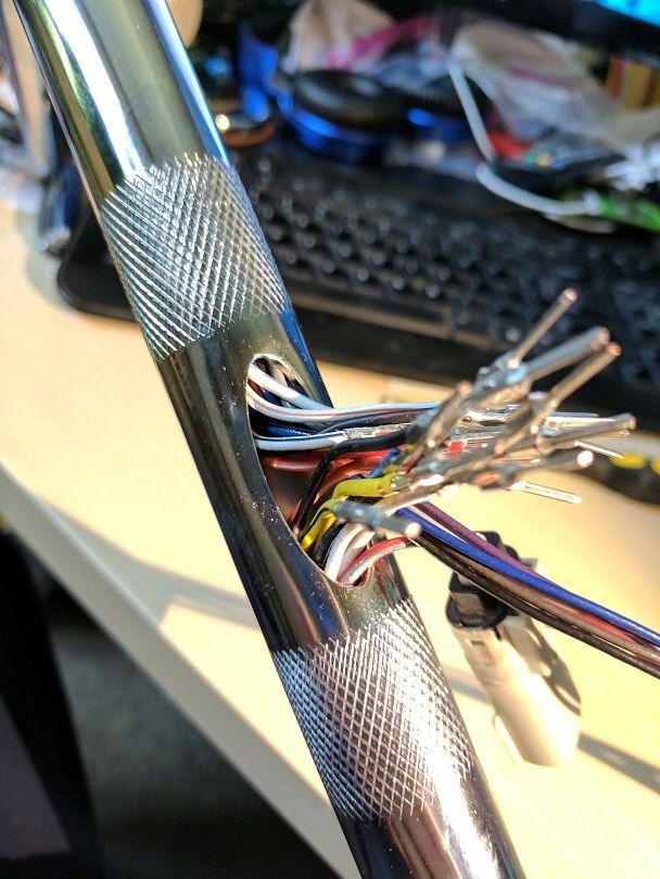

I did my bars just a couple of weeks ago. I went with Yaffe 10" Apes (1" dia.) because I'd heard that you didn't need anything beyond your stock setup. The pic shows where the stock wires wound up...
I ended up having Amazon overnight me the Namz 8" wiring extensions. I like them! I've still got 9 wires left over, which I'll hang on to for future use. The Yaffe bars had a small round opening, not a nice oval opening like I'd seen on other bars. The 1" bar made getting all of those wires stuffed in there a bit tricky, but I did it with some pushing, grunting, and mineral oil! (It's an all-around, multi-purpose lube!)
I ended up taking about 4/5 days (job, lack of wires, extended the task) but everything works! Signals, cruise, throttle, horn, and it started right off too! So, hooray!
I fed the wires in one at a time, after putting the TBW in all the way (with that fat green plug being just past the first bend) and then attached the wire extension to that mess of wire ends, shrank the heat shrink on them, then electrical taped them from just inside the opening to the plug ends.
Like others mentioned; take notes/pics on where those wires go in the plugs (since you indicated you've done this before, I'm sure you're aware of that importance!) and take your time. I inserted and withdrew the bundles of wire twice on both sides just trying to get them lined up just right, due to the small opening, but everything got finished really nice!
