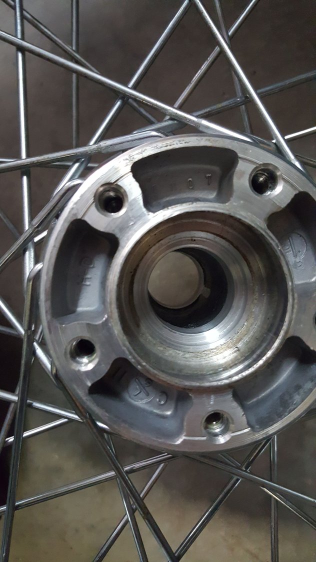

If there are no bearings you can tell by the shallow bearing pocket being the left, primary side. There should also be a machined groove on the face at the bolt holes if it's a Harley wheel.

Hey lt1-xjs, Here is a picture of the hub, the machined side is that the left side of the wheel?
