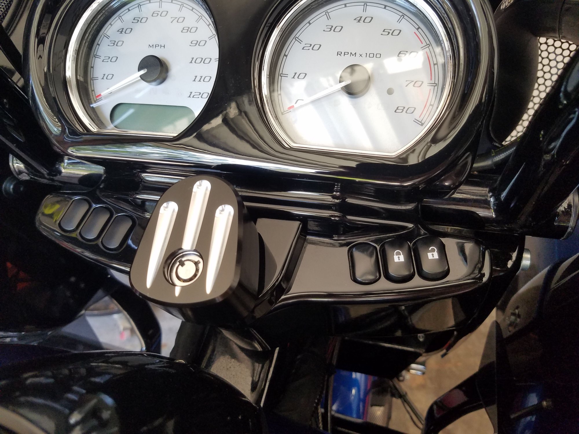

Yes I mean fully filled to almost 15". They actually extend to about 14-1/2" or so fully filled. But fully filled would be a terrible ride anyway. When I have mine at the right height they are probably a bit lower than the stock 12" shocks that came on my RGS. As far as the switch goes I'm not exactly sure if they could do that or not. You'd have to ask Ray at jnr designs if they offer something like that. I use the lock-unlock accessory switches in the dash under the ignition swith. They are momentary switches. I told Ray that I wanted to use those switches and it was already wired up when they sent it.
