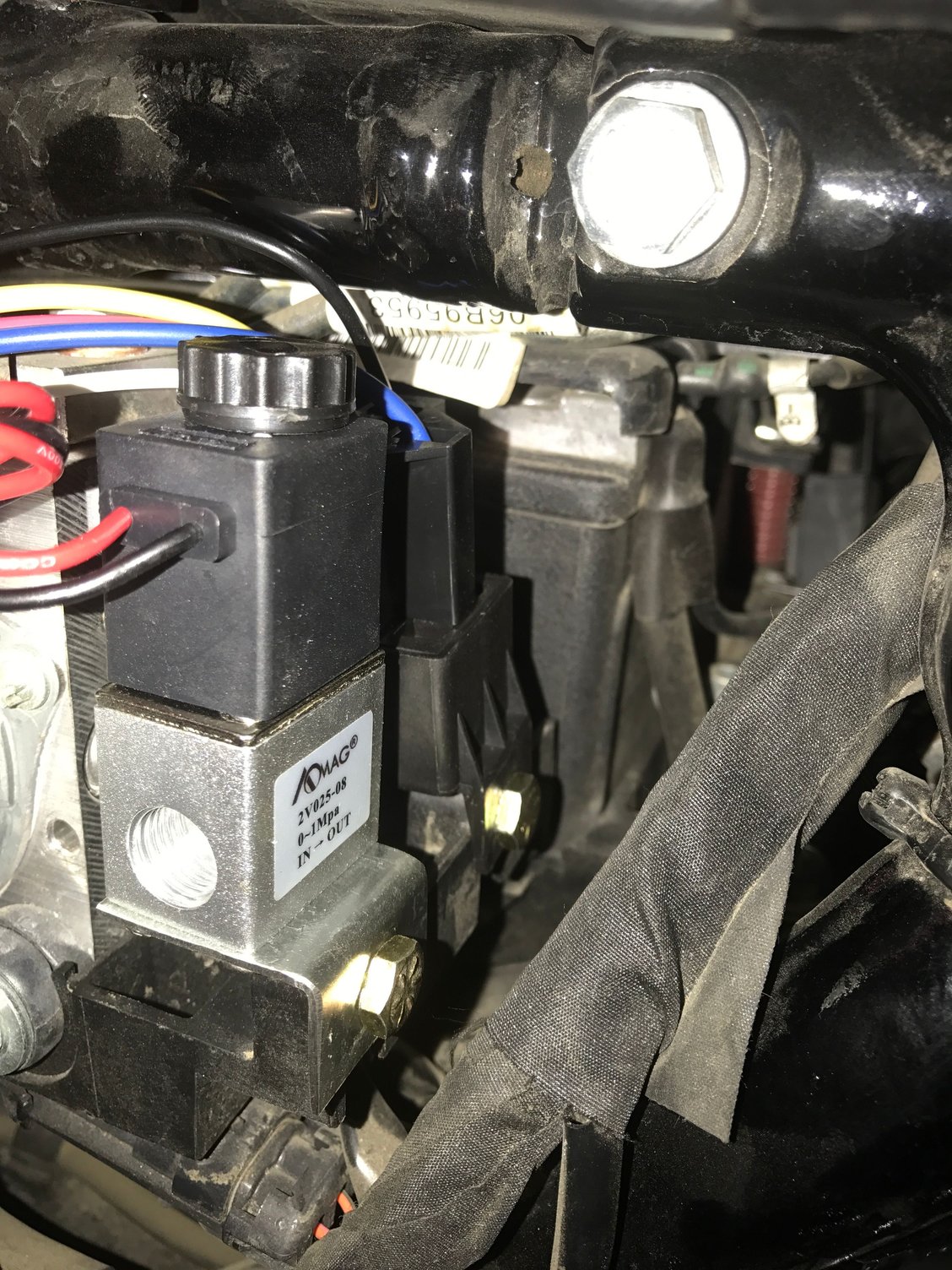

What brand selonoid has been holding up the best for everyone? I need 2 way 200+psi.

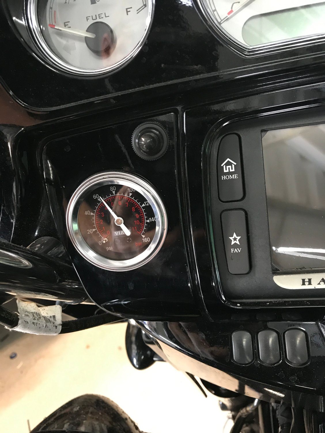

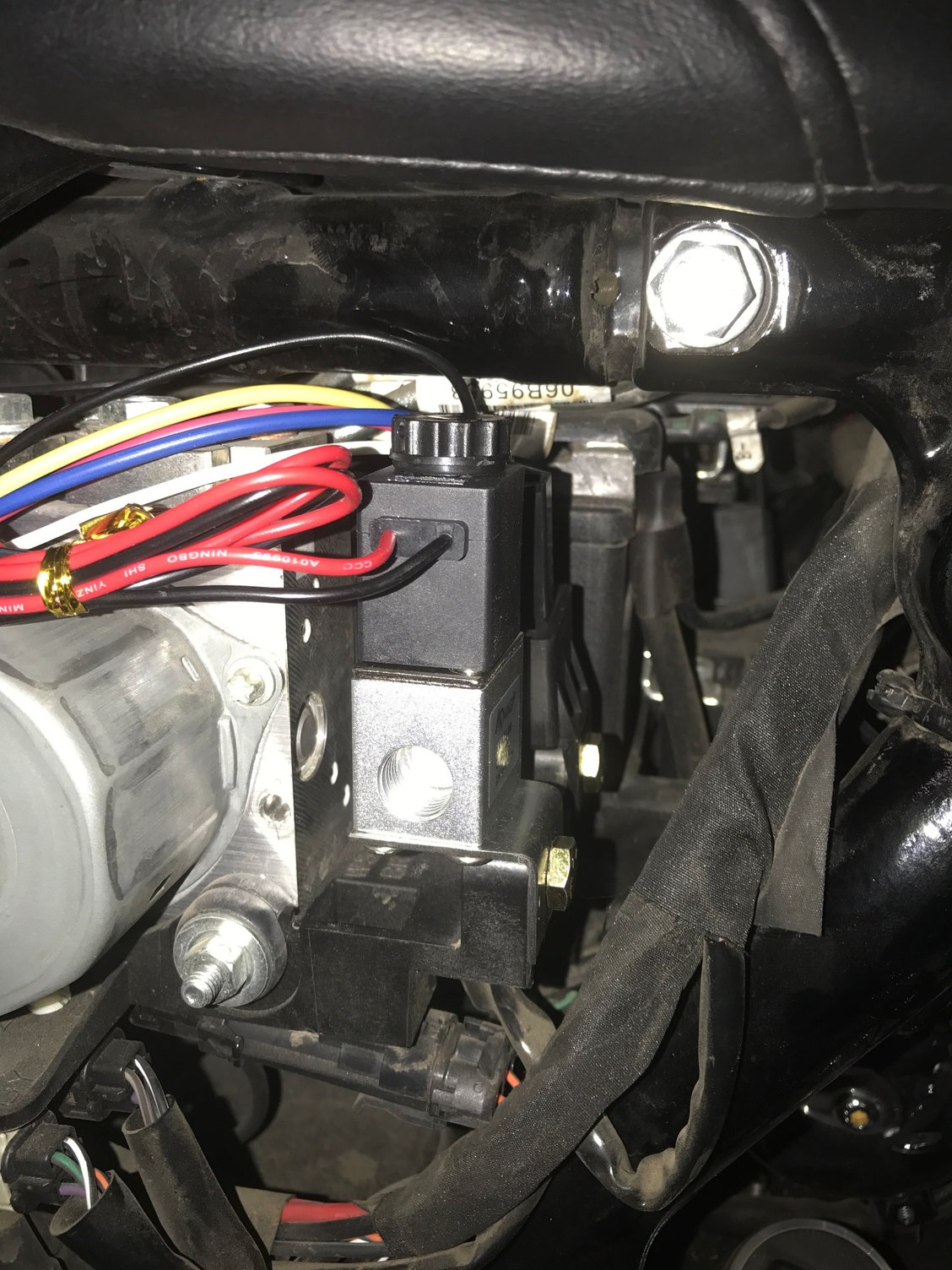

I did the DIY Monroe set up....I learned a bit about preferred air pressure. I use 90 lbs riding 2 up. (170lb & 150lb riders). The ride is sweet! I changed from Progressive shocks to Monroe air. Good choice IMHO. Haven't got any feedback on the jumper in the fuse holder yet LOL.....Jumper in for first test, didn't have a fuse handy yet. System fused correctly now and working great.
Solenoid and relay next to ABS system.
Skully compressor mount
Pressure gauge and switch in dash.
Hope you can read the label
