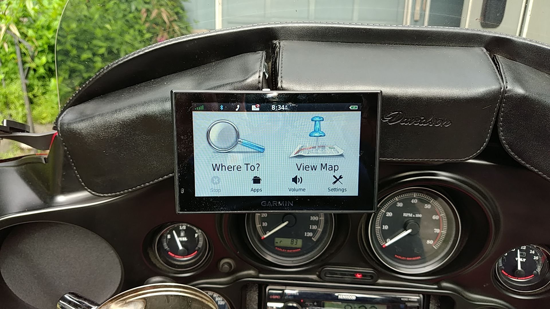

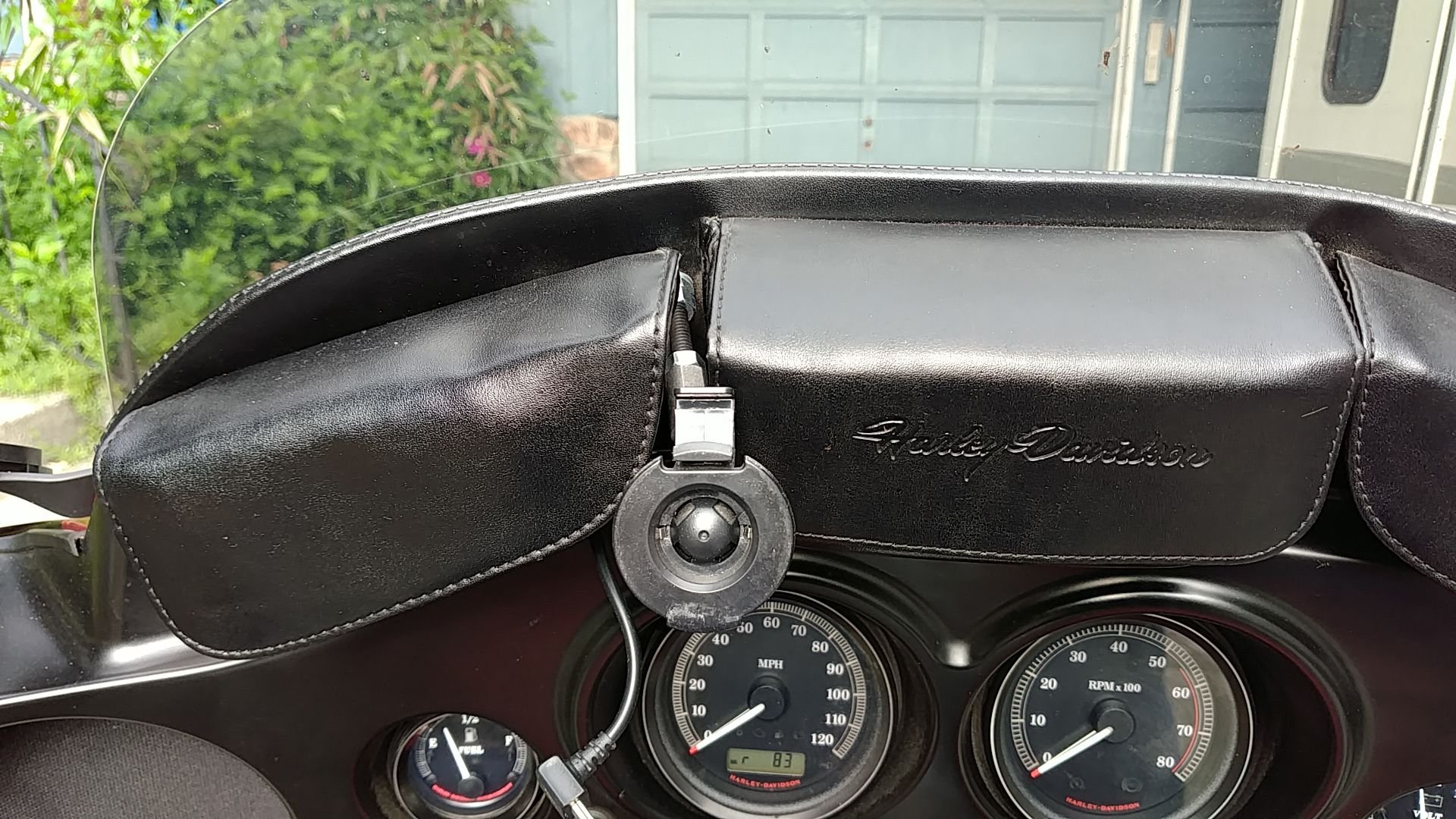

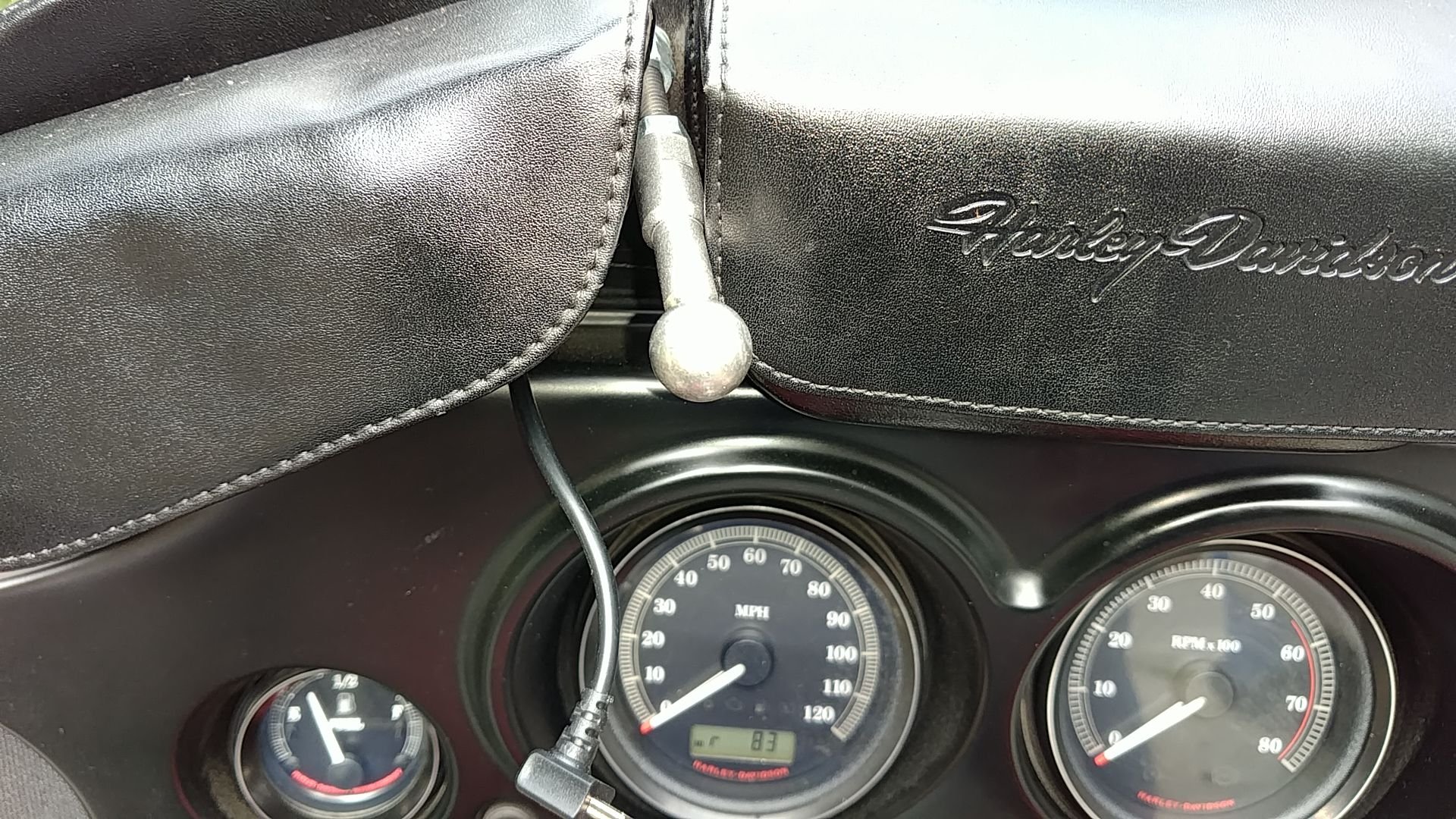

I drilled a 1/4 inch hole through the windshield 3 pocket backing. The put a metal 17mm ball using a 1/4 20 bolt and washers. It does vibrate a bit but is solid when rolling. I hard wired it inside the fairing so it comes on with the ignition.
