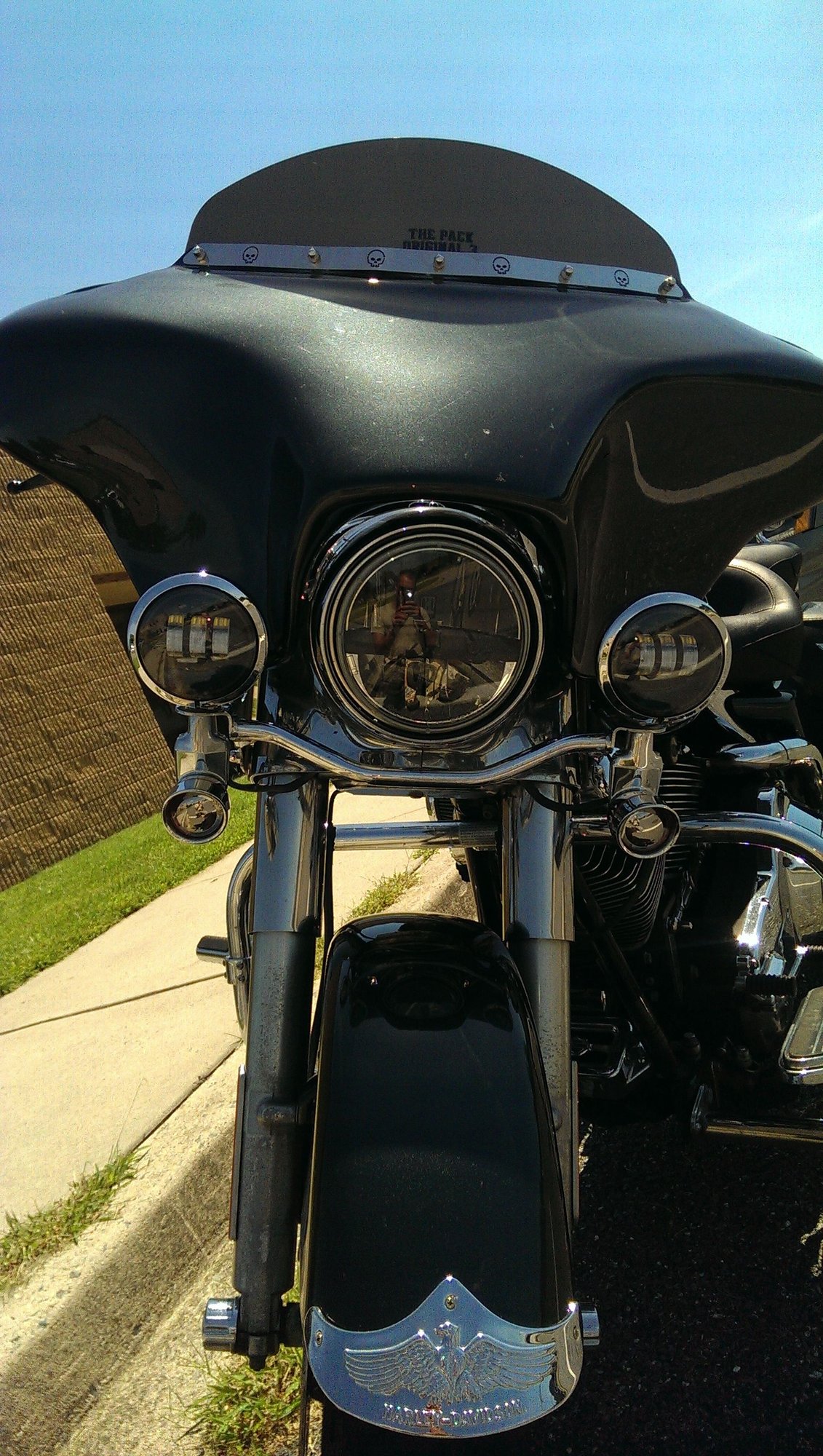

Here's my LED headlight set up. Headlight is a Truck Lite Phase 7 (http://www.ebay.com/itm/142399579000 buy it here for $70!!!!!- this is normally $200-250) Passing lights are cree. Those ran me $40 on eBay as well. Saw the exact set of passing lights at a shop for $150.
