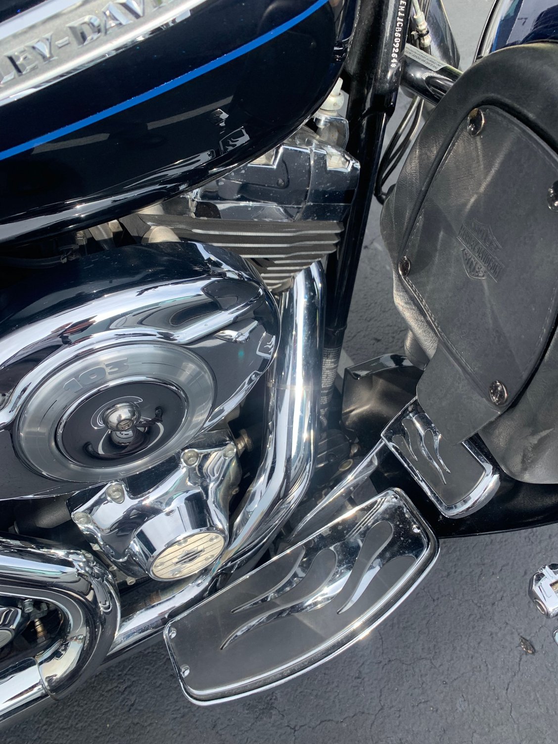

My front right heat shield is vibrating. I ordered some high heat stainless steel zip ties. If that doesn’t work I’ll try stainless steel pop rivets.

I used a heat resistant stainless steel zip tie. 100/$20.
Works perfectly.
You can barely see the tie. I put it under the previous clamp so it won’t rise up.
