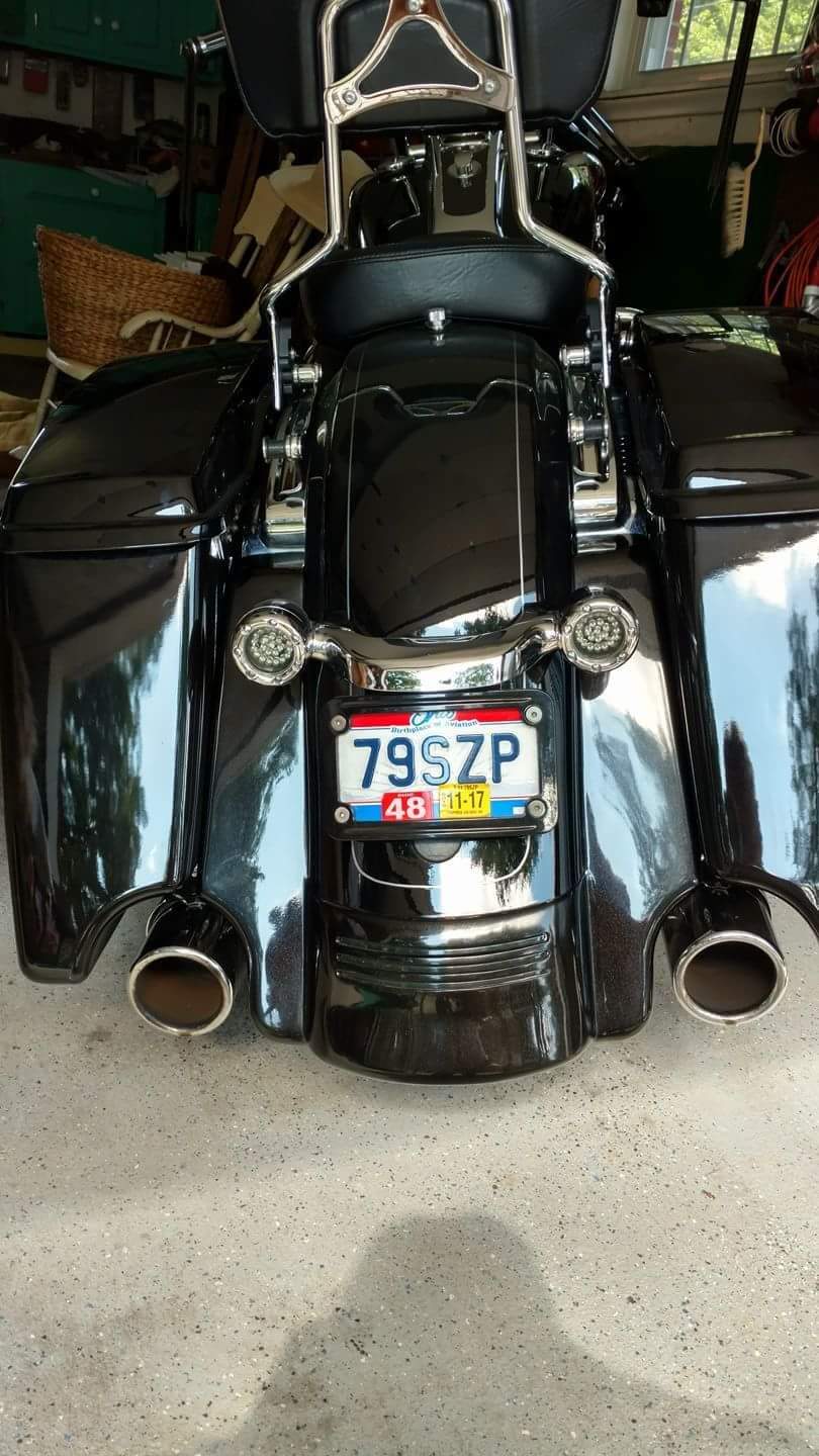

Installed a sg facia on RK with 3M auto double sided tape a couple years ago. Used tape on facia sides and the little fender tab that pushes the bottom of the facia up into the bottom of fender. It has not moved and is tight.
