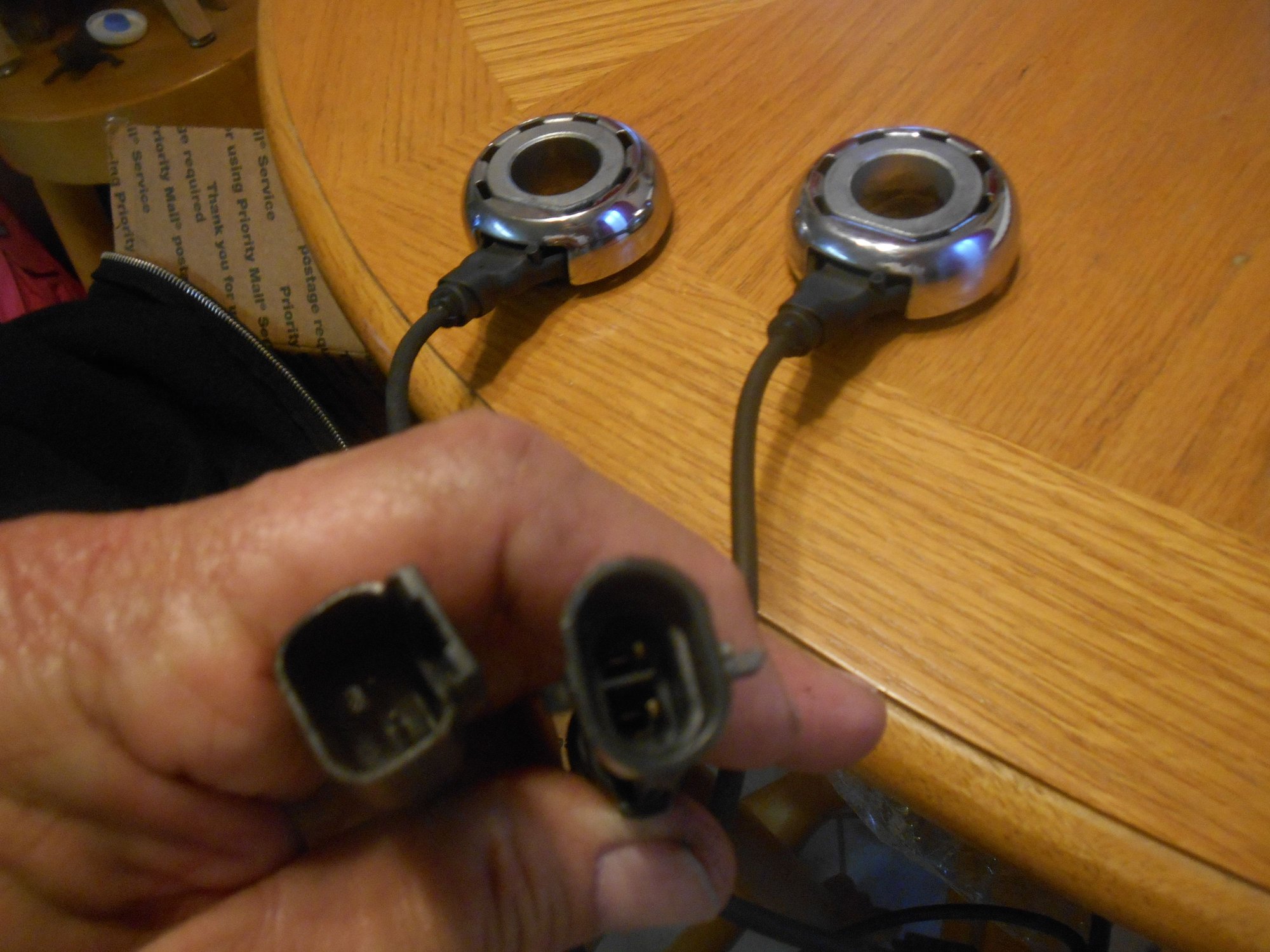

I got a 2012 Road king. My ABS light stays on. reset it on the computor several times. comes back on . I bought 2- take off sensors one may be from a 2013? ... The plug is a little different on the front sensor. My question do they make an adaptor plug? The wire looks braded and I think I may mess it up if I try to splice it??? any help?

If the plug is different, and you can't splice, you may have to buck up and buy a new sensor specific to your bike. I wouldn't have thought there was a difference between 2012 and 2013....

Part numbers and pics of sensors? Are you talking about the sensors that mount on the axle- front and rear? Did you change anything? Strange both front and rear would go out at same time.

OK I started with the computer and resetting it twice (on 2-different occasions) at my friendly neighborhood HD shop...the light came back on. The mechanic told me it may be the sensors. I build and work on old school choppers...(www.perrynelsoncustomchoppers.com). my first experience with this BS...Everyone telling me how great the ABS is I understand it...and it may be working sooooo....I just wanna get the light to turn off...I bought 2- matching sensors; because one was not from same model(I guess) and the other was for the front not the rear...well I got a refund on the one and the other came with an axle so I'm keeping it. The new(to me) set I just got came local and they have a couple more sets it they don't work...$50... anyway I'm starting(so to speak) here. I will try to reset the computer with the new sensors? Thanks for advice on flushing I will try that? I flushed my F250 brake sys out with rubbing alcohol...worked great...keep the suggestions comming ....much appreciated. sorry for long reply I work for a MC Magazine...lol

The 2-different type ABS sensor plugs I started this stream about. Both were told to me to be 2012 Road King compatible.
