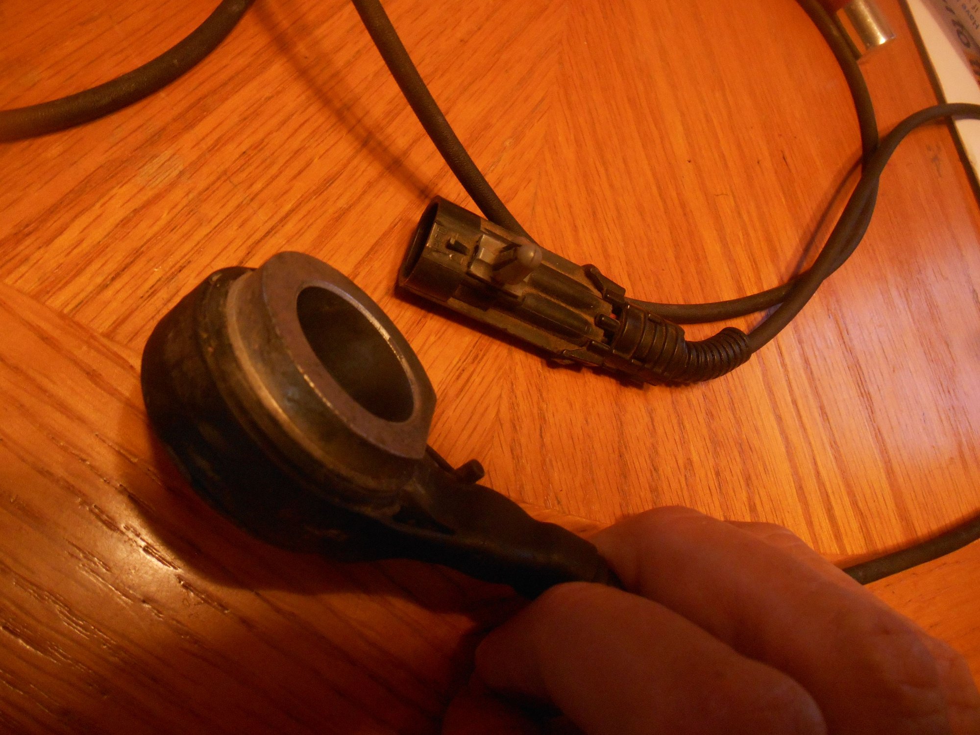

Originally Posted by Thezooboss
The 2-different type ABS sensor plugs I started this stream about. Both were told to me to be 2012 Road King compatible.
Definitely not oem and I think that is your problem. Are you trying to chrome out the bike or fix an abs braking senser issue? I'd put oem parts on to verify all is good, then move onto chrome goodies if that is what you are wanting to do.

Yes....rotated to stops....stays on while riding...I'm workin on it ....time to flush anyway...These shinny ones protect the bearing more. I bought an Axle that cam with the sensor the matching spacer for rt side and end caps...problem, unrelated to the light being on, was the plug was square sooooo... I got the one pictured matched with a rear sensor, that came as a working set. I will send a picture...When I flushed brakes(with ABS) on my truck the ABS light went on when I flushed and the ABS light went out after I added and bled calipers...Truck didn't move...TDK...

Axle I bought for 60$ came with goodies, wrong plug for front sensor ...It's straight I will use it...
Double f'd... Ok if you guys are following this lol; this was the Rear(working) sensor I bought that I got credited for that happens to be a OEM front(notice 1/8 inch wider than rear OEM sensor)...sooooo I have this one on the front till I flush an whatever i have to do to get the light off....Thanks again for valuable info you guys...
