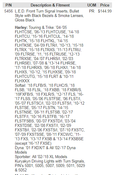

Originally Posted by leon anthony
the Kuryakyn harness is P/N 5456
Might be wrong p/n?
From Kuryakyn website:

Hammz the part number I posted is for the wiring harness that lets you run your Aux light with your high beam on
Might be, but I posted what that p/n came up with on the H-D website. Also, no wiring harness adapter is required to run aux lights while on high beam; it's a software change only on the '14 & later CANbus bikes.

ok then the P/N I posted must be for the 2013 and down
