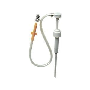

You could try to suck it out thru the fill hole before removing the side cover. I have a little hand pump that is made for screwing on to the top of gear oil quart bottles for use on lower units. It has a rigid plastic tube thats made to fit down inside a quart of gear oil and on the other end a flexible hose. It will suck the oil out and displace it thru the flexible hose into whatever you put it in. It will work without being screwed onto a bottle, if you have room to slide the tube in or can change it up for what will work. Something like this, they're cheap...
