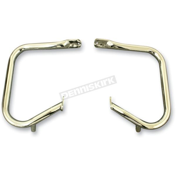

Yep, you could buy above and the cheapest route. But if you want to beef it up you could gat ya a set of Big Buffalo guards. I have them on my old bike and very hefty indeed. Hope the mods are okay with the pic but pretty sure I got mine from DK.
https://www.denniskirk.com/495977.sku?ad=81570026493983
