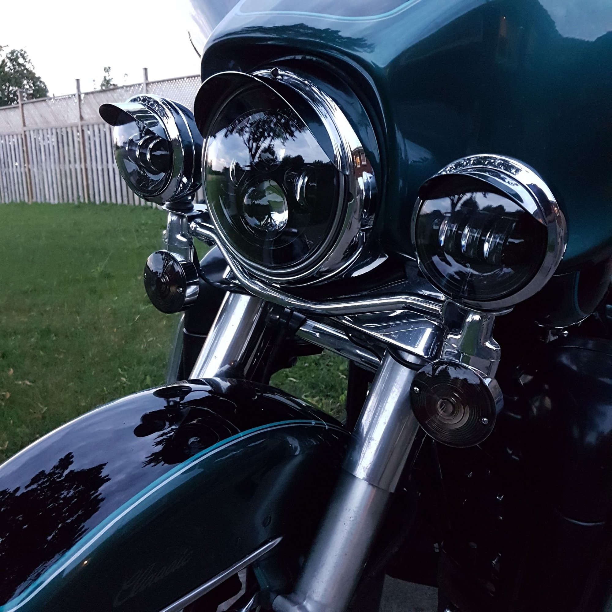

I also have the Sunpie ones. They work great for me.
I did not buy the spacer ring, I just trimmed out the factory bucket with snips until it fit. My visors also fit with little effort.

That looks great. I think I am going to go to led passing lamps when my bulbs burn out. I have the visors as well.

Thanks. I went with the black Sunpies which ties in with the smoked signal lenses.
The spot lights I had to hardwire inside the lamp housing because the supplied connectors did not work on my 02 FLHTC. Easy stuff...two wires.

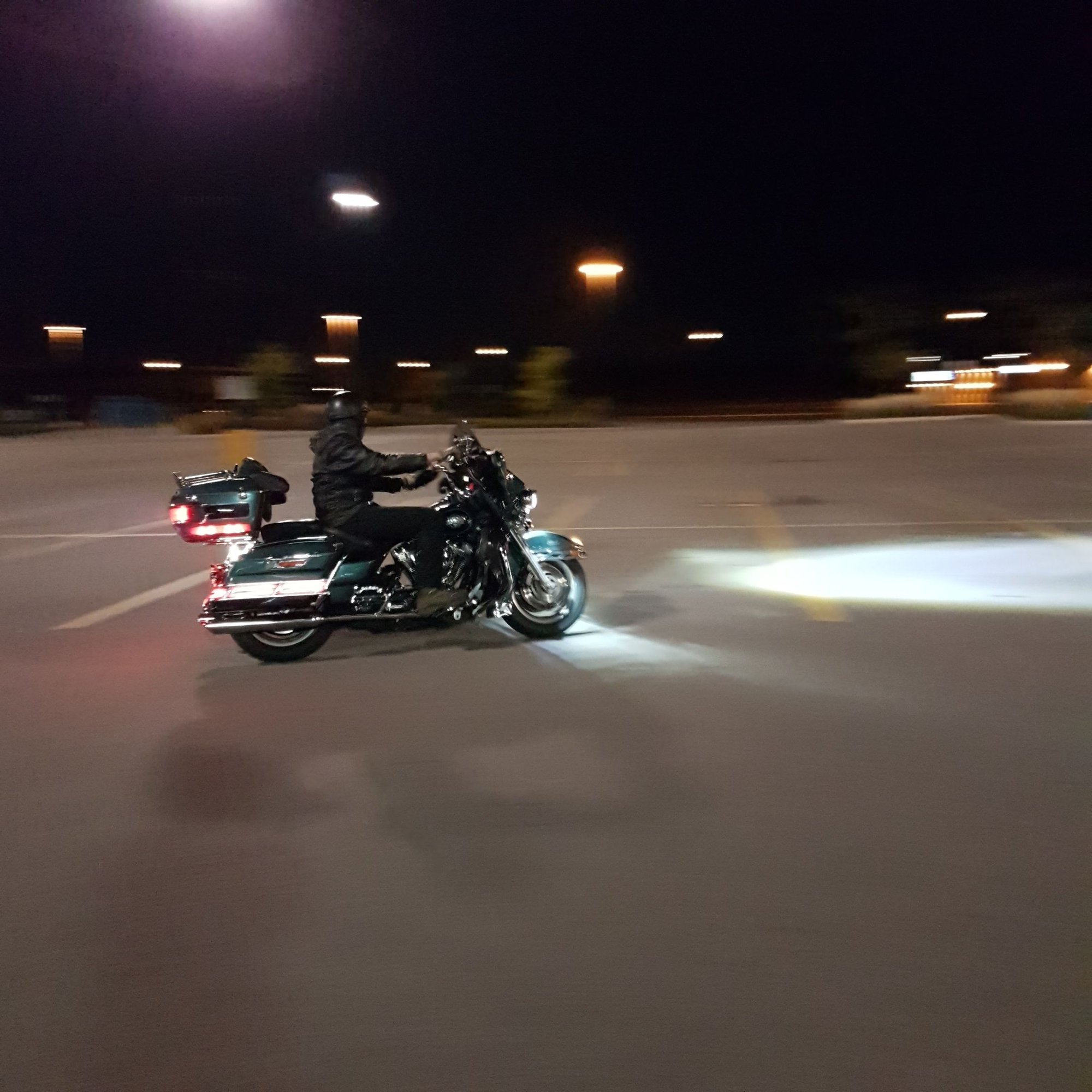

Any pictures of the beam they throw on a wall? A beam shape similar to what they replaced is important. Any radio interference?

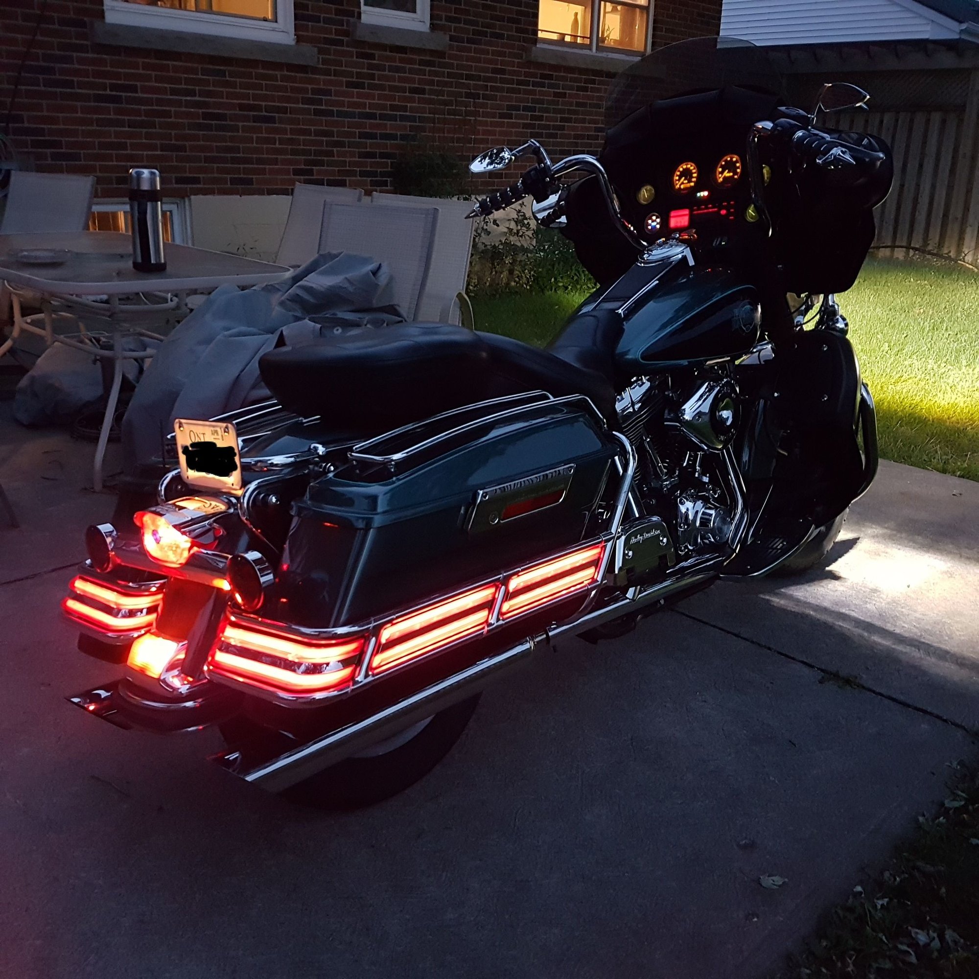

No radio static at all on my bike.
Beam pattern is much more defined with a sharp line at the top where the light stops. Height adjustment is important to prevent blinding oncoming traffic.
Unfortunately I do not have a good picture of the beam, but these might give you an idea...
My son's first time riding a Harley...
