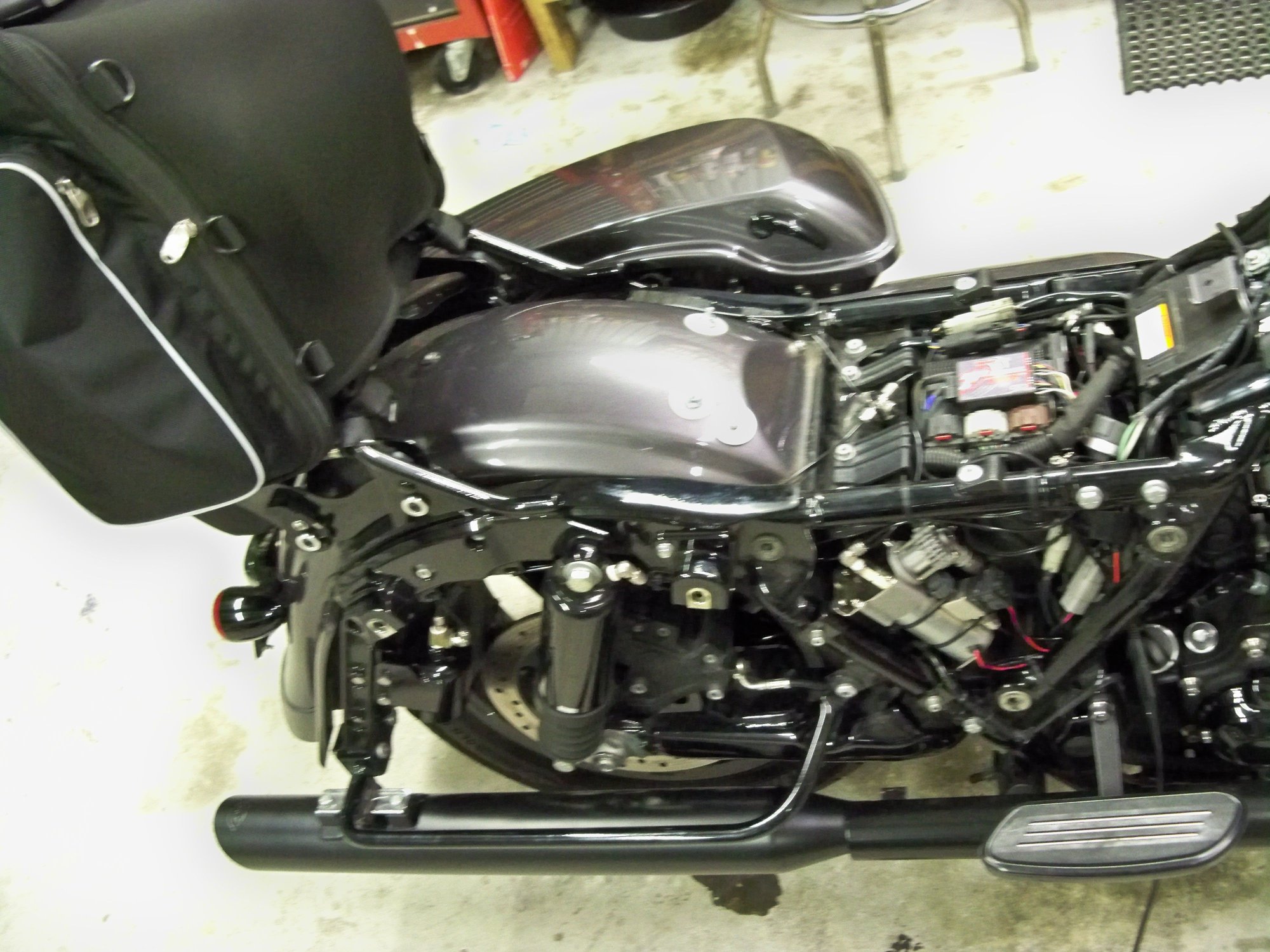

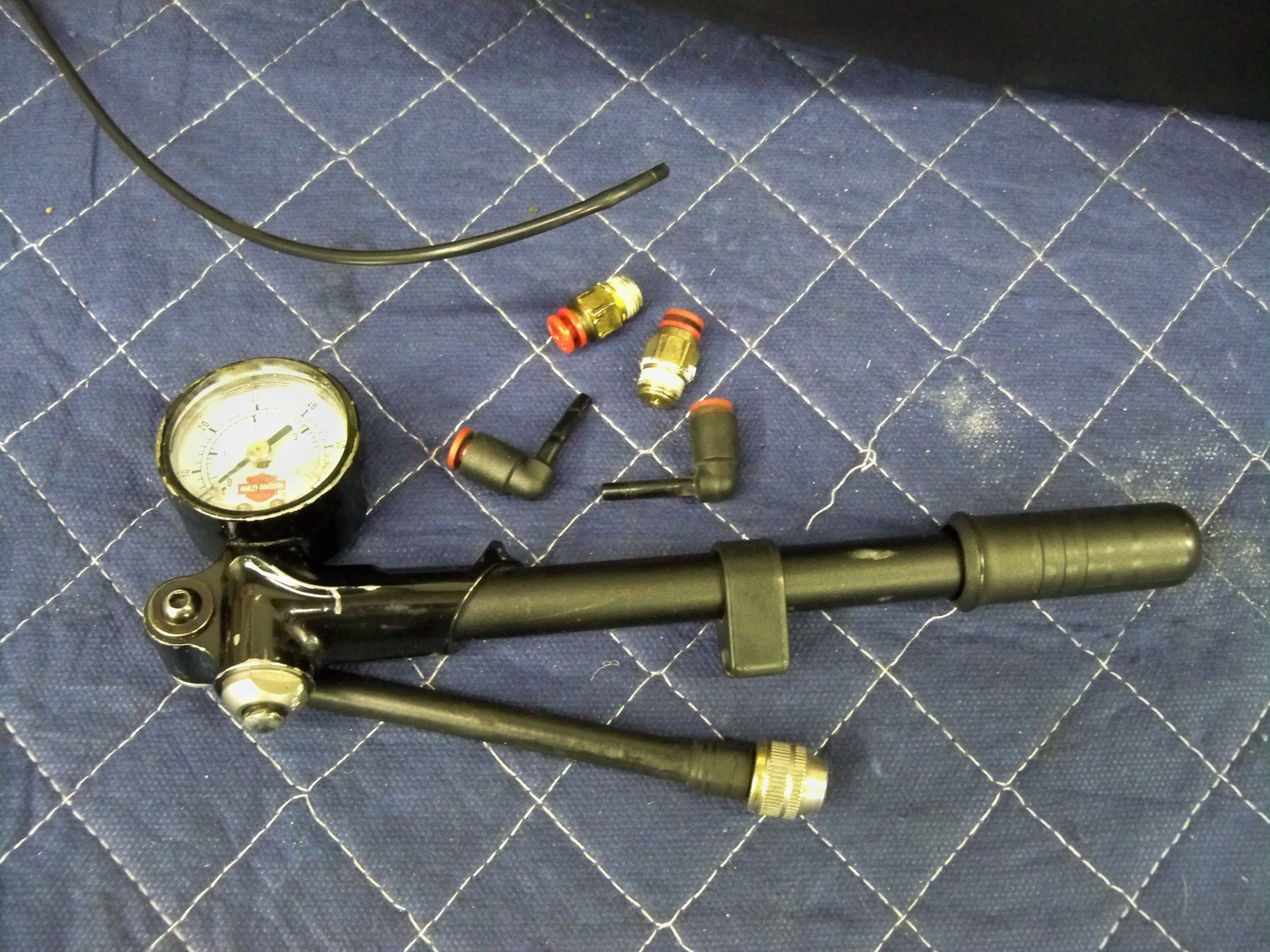

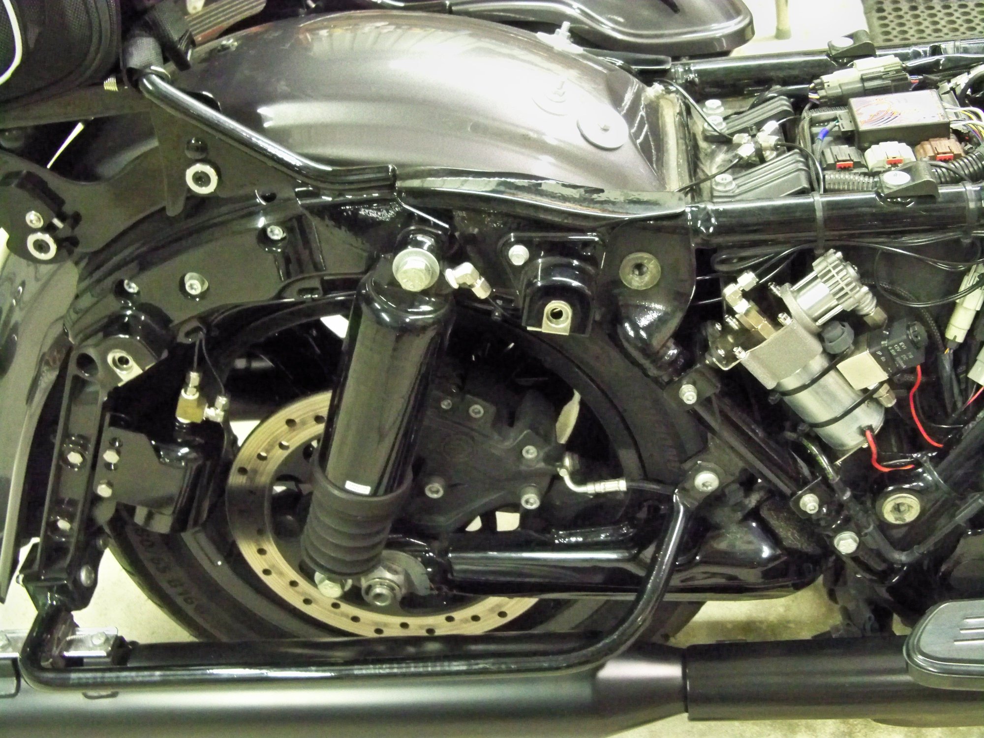

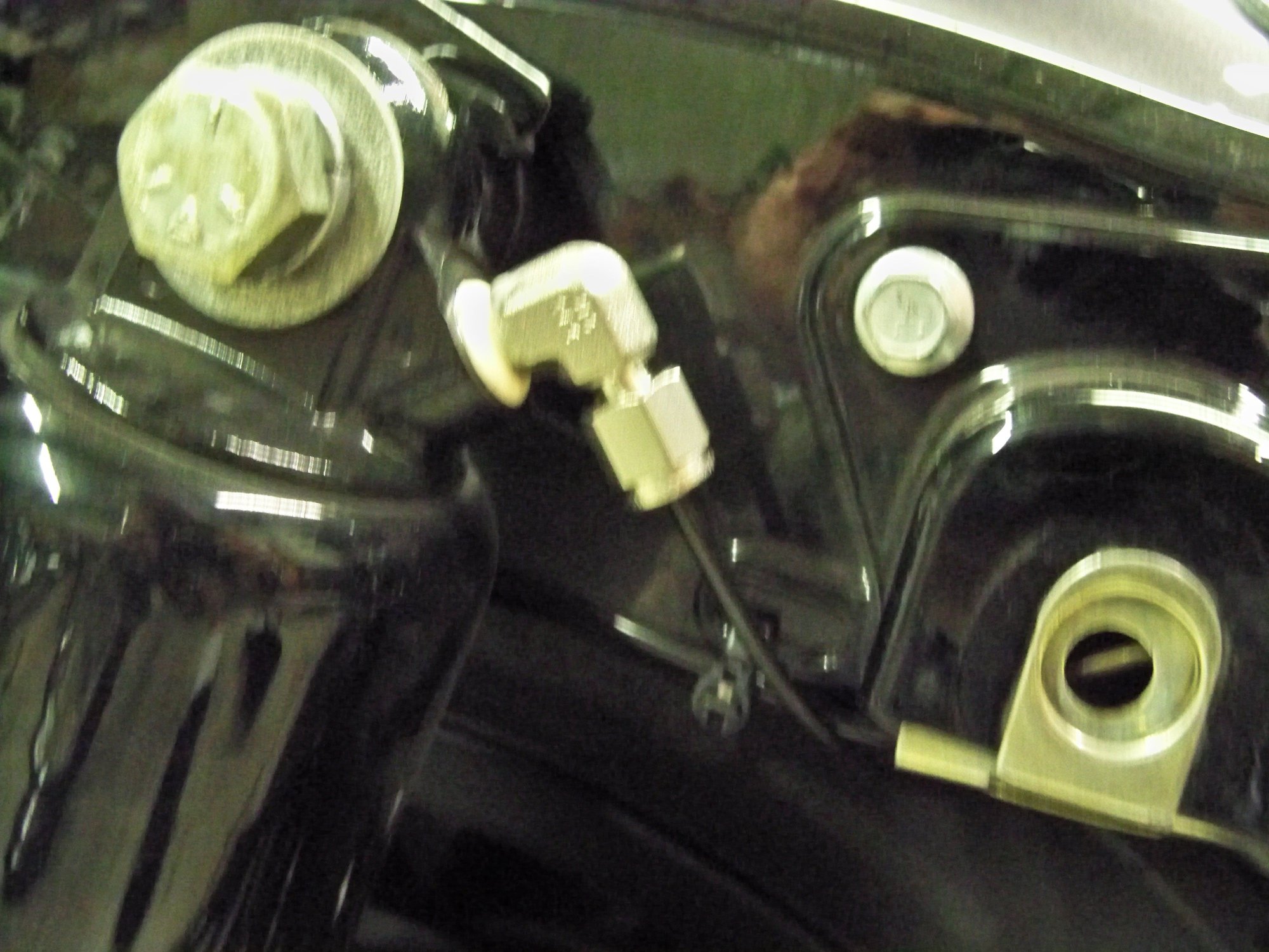

well , we have found that the problem with the stock rear air shocks is not the shock it self but the fittings and the inability to maintain the pressure ...or adjust it on the fly as road conditions or load changes....and that cheesy little hand (so-called) pump !!!
we added all the components for a lowering air ride system but retained the stock air shocks ....
used a nut and ferrule type fitting and better tubing for a no leak system ...now we can adjust the pressure up and down as needed on the fly ...
the ride is very smooth ...when adjusted correctly ...no issues ..
all for less than $100 bucks ...and works and rides great !!!
Just our 2 cents !!!
this **** is the problem with the stock air shocks
added small air tank from police air ride seat
dash mounted air gauge
nut and ferrule fittings ...we used stainless but brass will work just fine ...
then we can air up a flat after plugging it should anyone catch a nail or something when on the road ...connect straight to pump and reach 10-12 feet ...
