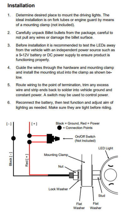

The bullet ringz are replacement lighting for turn signal/running lamps; they stay on all the time (white light), flash amber when turn signal is active. Since they replace the oem turn signal/running lights, they do not shut off on high beam (nor do the stock turn signal/running lights).
https://www.customdynamics.com/front...arley-davidson
As for the Cool Magic Billet Bullets, you'll need to install a switch to control them:
