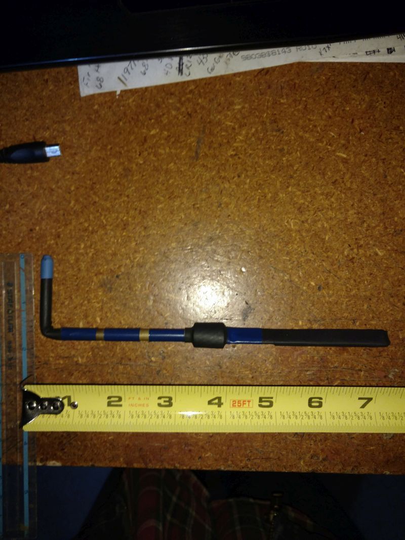

Use a screwdriver to align the ignition or better yet make a tool from a piece of brass tubing and some electrical tape. 9 1/4" piece of 1/4"tube. Bend at 7 1/4" as to make a handle and flatten the lower 3 1/4". Wrap in your favorite color of electrical tape or shrink tube.

FPV,
I have performed three handlebar installs in the past years, this is my first issue.
I will try aligning the lock later today.
