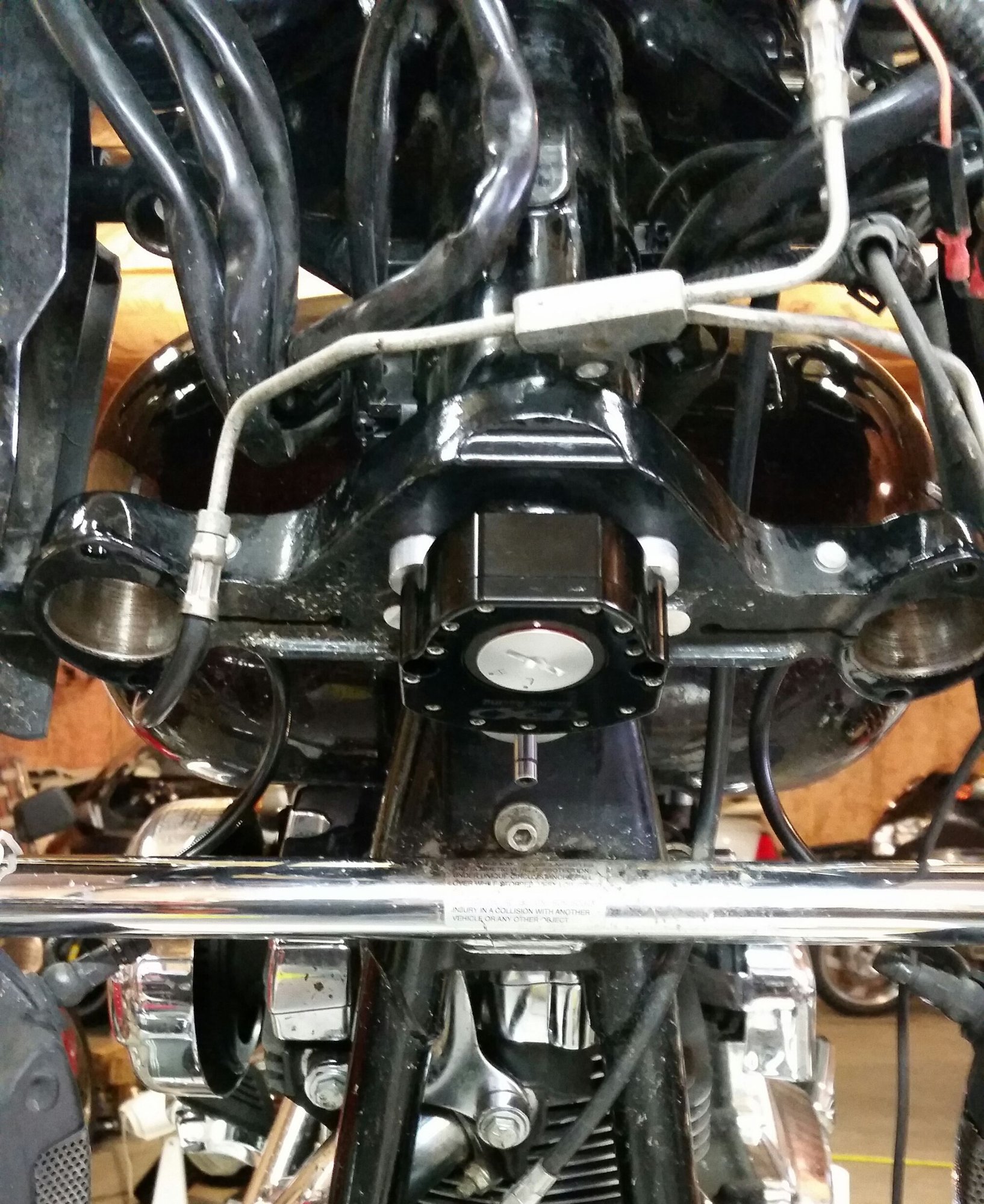

This has been one of my winter projects. I've always felt my 2011 SG might benefit from having a steering dampener, it has always had some kind of bobble/weave when I'd hit a bump in a sweeper.
So I figured I'd just try one and see. I'll let you all know if it helps.
Please do report here. I'm very interested.
My brother has ridden Harleys since the 70's, including a very long ride in his custom built, rigid frame, 16' over wideglide front, Panhead. I remember him talking about a wobble once at a high speedon one of his newer bikes. Next time I see him I will be asking him about that.
Also, it seems that at one time, steering dampners were not all that uncommon.

The TriGlides come with a steering dampener. The components should fit the same model year.
But, if you didn’t have this issue before I’d be thinking something changed.
