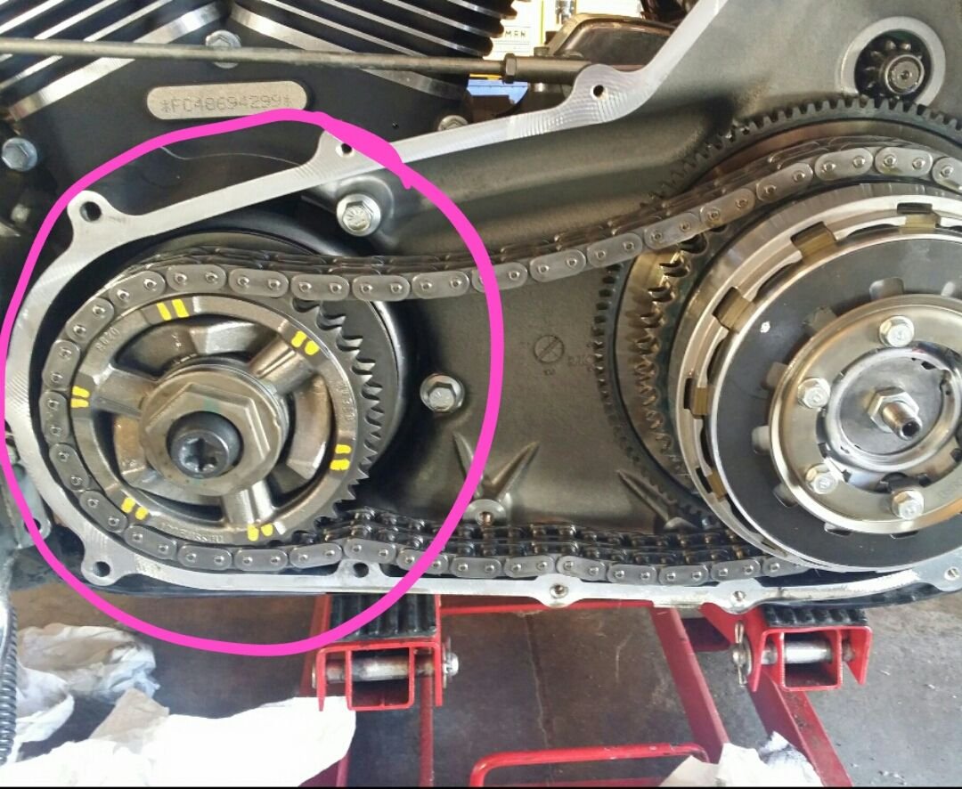

2008 FLHTCU, have everything installed...(chain tensioner next)
EDIT- see video a few posts down (post 8)...the 7-8 second mark in the video- any idea what that noise is when shutting down?
Thanks.
___
My question is: should the new SE compensator 'move' or rotate at all if I try to rotate it by hand? (when bike is OFF)
=> It doesn't either in neutral or in gear (clutch hub installed and clutch was adjusted)
Removing the old compensator, it DID move as did the clutch hub, they would rotate if you tried by hand.
Help appreciated. it is torqued to 175 per the instructions. Thanks.

If your hand is strong enough to rotate the crank then yes it should move. Although I don't now of anyone that can do that. Install the tensioner and give the starter button a quick tap. You'll know right away if it's installed correctly.
sorry I don't quite understand your answer (bolded in RED). Should it move/rotate by hand? yes? or no?
Don't want to put on primary cover etc only to have to redrain it and remove it again to get to where I am at now.
Thanks.

If you remove the spark plugs and take it out of gear you should be able to spin it over

I never tried to spin it by hand as it takes some serious leverage to do that. The comp should essentially be just an extension of the crank when installed correctly and it's near impossible to spin the crank by hand. Your old comp was worn out thus the reason you probably could achieve movement "by hand". Assemble the tensioner but don't put on the cover and hit the starter. If she starts just shut her down. Won't hurt anything just don't ride it w/o the cover and fluid.
so that means it is installed correctly if there is no movement or ability to rotate by hand....? unsure whats normal for a new SE comp.
guess I could pull the plugs and try...but was hoping for a definitive answer to just move forward on this job and wrap it up. THanks.
ok I think I see....once the T70 is tightened up the comp should only move/rotate if the engine is making it rotate.
Unless I pull plugs etc (as mentioned above).
(Picked bike up used, stock comp only had 10k miles on it.)
Further question....did fire it up.
Note the noise at the 8 second mark in the video, any idea what that is? I don't know if thats due to no fluid present etc?
any idea? (anyone)
Thanks.

Got the headphones out and is it that heavy tap you're hearing? Watch your tensioner bottom out in the video? Is that what you're hearing? With fluid in the primary I suspect that will be dampened.
Sorry for the delay in replying. Was out rescuing another orphan.
I know....It's not a harley but it's cool and I use to have one 30yrs ago.
no worry. Its Sat night not many around. I'm just trying to wrap this up. Cool bike. any bike is a good bike.
Interesting observation....that is the Southern Hot Bikes tensioner, its hydraulic....I wonder if that is making the sound. Super hard to tell refiring the bike again and trying to lean down and establish where the noise is coming from. I think you may be right?
With fluid i am wondering if that tap should stop (w/ the tensioner)
