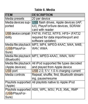

Here is the link for the Boom Manual:
https://www.harley-davidson.com/cont...Box-Manual.pdf
The picture shows it is USB 2.0. I have been able to read a USB 3.0 formatted FAT32 and NTFS. Both flash drives are 64gb.

It's read speed will be at 2.0 speeds regardless of whether he uses a 2.0 or 3.0 compatible USB device; the radio hardware is 2.0 & that's the speed of the interface.
