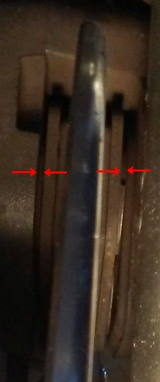

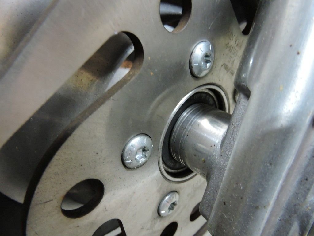

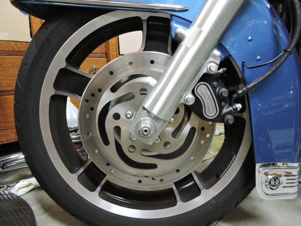

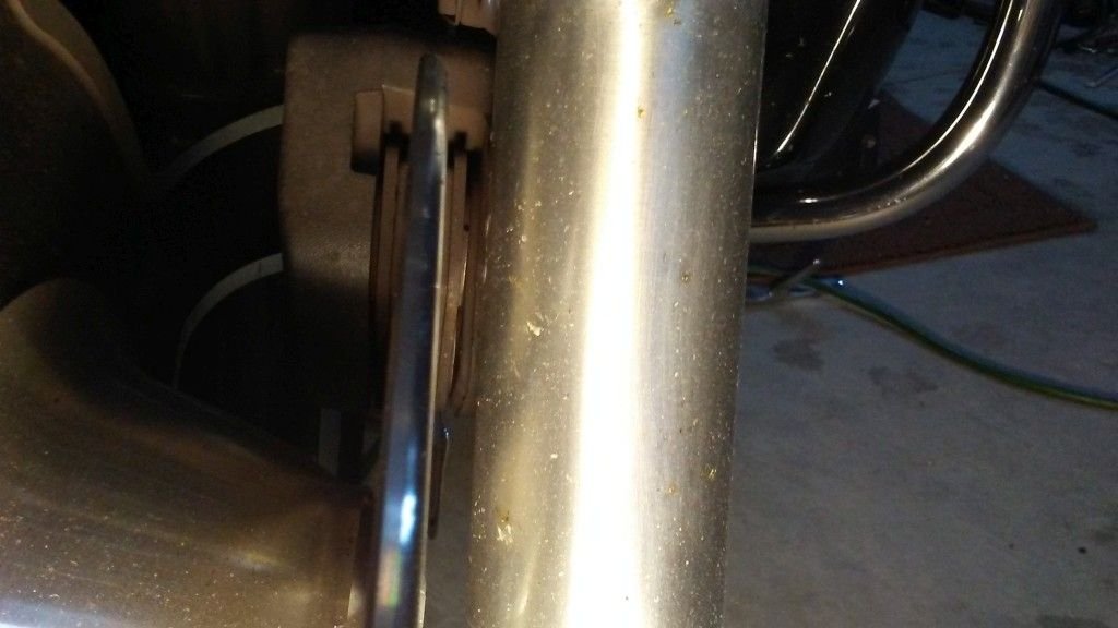

The following is pretty much the exact scenario you presented (or one them)...I had a bike conveniently close for pics
2005 FLHT
* 2000-07 Rotors and Calipers
* 2010-13 18" Wheel with OE 25mm x15mm wide bearings
* 08-later Wheel/Axle Spacer
* 08-later 25mm axle
The Rotor-to-Caliper Alignment looks pretty close
BTW, I can also make that wheel work any which way...using 1" axle with 1"x15mm wide bearings (aftermarket bearings)...OR 1" x 21mm wide 2000-07 bearings with custom spacers...simple stuff, easily Calced without any"Mock Up" when you know all the dimensions

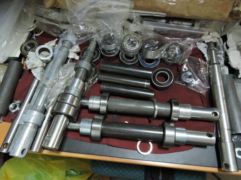

"Have you done the swap?" ... The "Don't insult me" was kind of in jest,...but then I started thinking about people not knowing where people are "coming from" so here's a pic of one my "Catchalls"...a small portion of extra of the axle/bearing stuff...the bearings in those bags (9267,9247, 9276, "A", "B", 9252 ABS), all torn apart to see the construction and differences. I won't bore you with pics of the all the extra wheels
