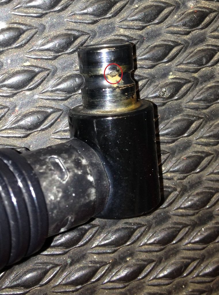

Originally Posted by Vesa Kuivalainen
i turn this pipe... Bike work and then i turn more...engine stop?? Turn more back side engine running very well, maybe problems found , tomorrow i TaKe gas out and check this parts but what is this partsnumber. It maybe found ebay.
Part # 62900-01D Fuel line to intake. Ronnies online list the price at $40.99
Old Jun 17, 2018 | 12:39 PM
Vesa Kuivalainen's Avatar
Vesa Kuivalainen
Stage IV
Joined: Jun 2018
Posts: 4
From: finland
Originally Posted by Guntoter
In addition to the fuel filter, which probably is due for a change depending on mileage/kilometers or a hole in the internal tank fuel line, it could very well be the fuel line from the tank to the throttle body. If it shows wear like the photo below, on the fitting that goes into the tank, replace it as it is shutting off the fuel flow through the one way valve mounted at the tank.
Bike work now perfect, picture show old and new parts, somethings cratch show it. I change same time gastank innerpipes and that couplin. Thank you very much, now i drive to Lapland and ne happy!!!! -vesa-
