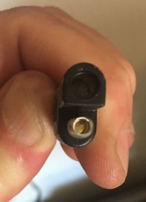

I did not pay the extra $10 for waterproof tender; mine charges in the garage.
My wall connector only has two connections, the connection on my bike has, what looks like an extra connection.
I always assumed that was a ground for the waterproof charger.. though I never cared because I charge inside.
Is this, third connection on the Bike battery tender connector what the OP was asking about?
Is there a third contention present on the waterproof tender?
BIKE battery tender connector :
WALL battery tender connector

1.2 amp tenders use a two prong pigtail. Five amp tenders use a three prong pigtail hence the three prong connector on the factory installed pigtail.This is per Harley installation description on their factory harness.
