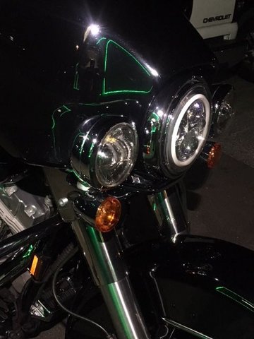

Originally Posted by REPO1
Just buy some used/take off street glide signals. They plug right in.
i looked at those if i swapped over to those the passing lamps would have exposed nuts plus not sure if they would be seen behind the passing lamps
Old Jul 4, 2018 | 01:44 AM
stroker87's Avatar
stroker87
Joined: Jul 2016
Posts: 357
Likes: 39
From: illinois
got some bullet front signals from a member here got around to getting them on tonight was not to hard to mod them to work
really liking how it came out, hated the stock pancake lights that was used from 1986 to 2013 i think it was?
drilled the housing on the bullet light so the passing lamp bolt would fit then used a 1/4" spacer worked out perfect.
