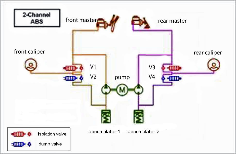

Without activating the abs, old brake fluid remains in the abs hcu. Bleeding, then activating the abs while riding will mix old fluid with new. Bleeding again will change that mixture. Activating the valves/solenoids while flushing will force old fluid out of all abs circuits.
This schematic was taken from BWI, the abs supplier in 08-13, web site a couple years ago. The supplier removed all info about these abs units when **** started to hit the fan a couple years ago. Read the below schematic to draw your own conclusions on the best way to flush brake fluid. But please dont listen to the misinformation that a few are still posting as brakes are too important.

Interesting comments on both sides...... This is a rare case of two different positions on a subject, backed by what each poster considers proof of their "theory"... This isn't, in my opinion, a case of an expert giving indisputable evidence being countered by someone just repeating hersesay or an unsubstantiated theory.
By the schematic, if correct, it all depends on the default/running settings on the isolation and dump valves.... unfortunately, to put this "debate" to rest, we would need that info... I don't have it.... and I haven't seen a reliable source quoted. BUT.... If the default running position is an open isolation valve and a closed dump valve, it would be likely that some fluid would be trapped in the circuit from the pump, to the accumulator, and through the dump valve. If the default is that both the isolation and dump valves are open, it would be possible to get a complete flush, but looks like a short flush time/volume, could still leave some old fluid in the pump to accumulator, to dump valve pathway.
Kumaride offers a schematic to back his theory of fluid flushing.... I just don't know if the schematic is truly accurate, or the default positions of the valves..
Alarmdog offers a line in the service manual to back his theory of fluid flushing.... Yeah, good source. Yet... I've seen the manual be less than accurate before, both by accident or to push a MoCo preference...

I BELIEVE, that even if Kumaride is correct, that there is a very small percentage of the old fluid left/trapped in the system, if it is just flushed out without actuating the ABS system.
What I have, and will continue to do, 1st on my '12 Limited and now on my '16 Ultra Classic (yes, I know the '16 has a better ABS system), is to flush the system, take if for a ride activating the ABS a couple times, and then do a re-flush. It's only done every two years, so not a lot of work, and DOT 4 really doesn't cost so much that a double flush is outrageous,,,
