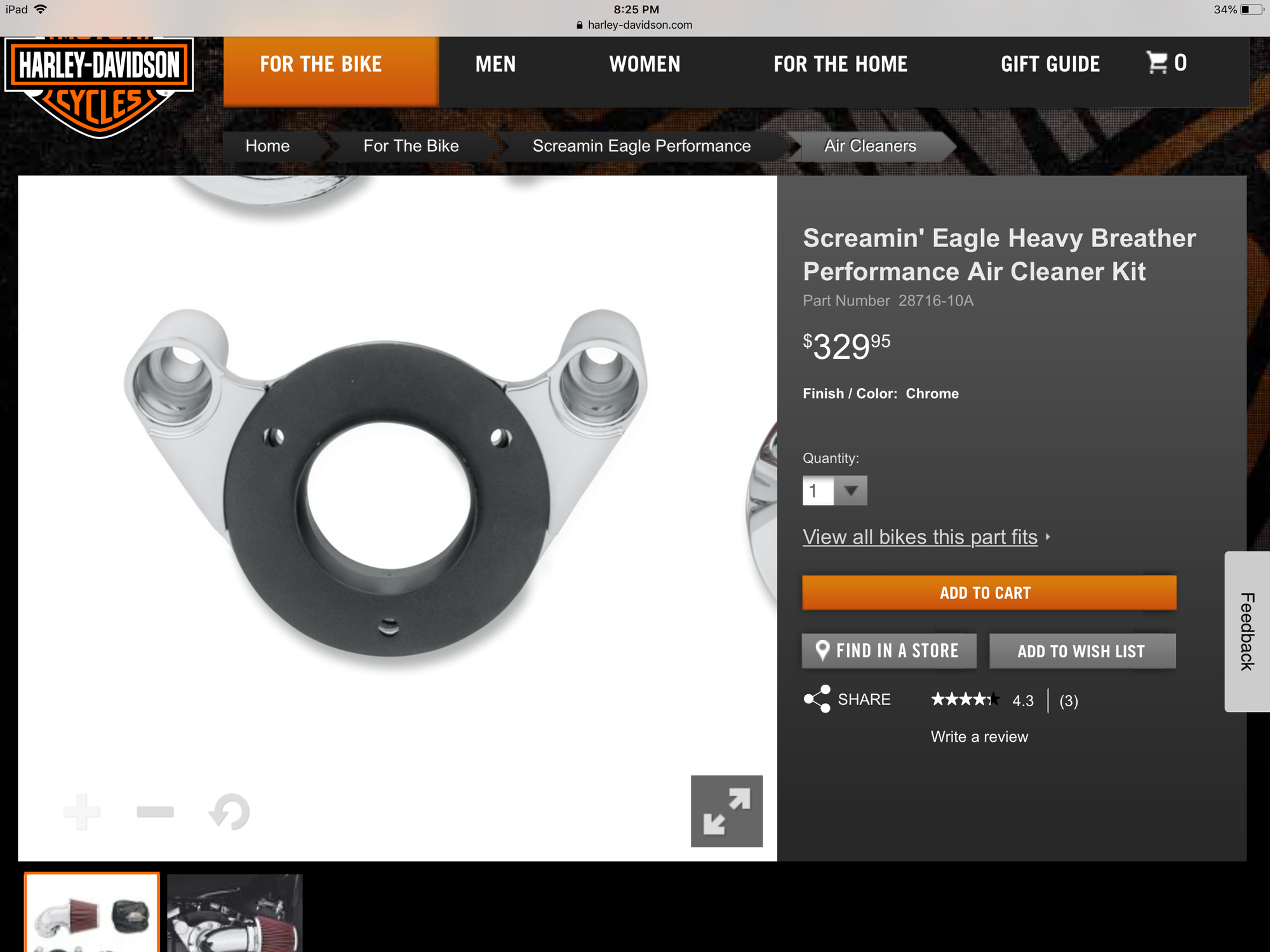

I was just looking at the directions for the installation and a question comes to mind, you might want to ask your dealership this question. "After installing the chrome caps (#4) how do the oil vapors from the heads get back into the throttle bore to relieve pressure?" Maybe there is enough room behind the caps that the vapor is allowed to pass thru the flange to the intake.. Just looks a bit ***** to me.

Inside the cavity that the chrome caps cover are holes that create a passageway into the intake. As the breather bolts pass the vapor, that vapor collects and flows through the drilled out passageways where it gets sucked back into the intake to be mixed with the fresh air coming in to be mixed with fuel and burned.

I just relooked at it and the post above is absolutely correct... pull those plugs and be sure those passage holes in the casting are not obstructed. You can see them in the pic at about 6 o’clock, the gasses or whatever come out of the breather bolt ends and then go thru those passages inn to your intake and get burned.

Did you read the instructions? Sorry couldn’t help it! There’s a picture in the instructions of the OEM breather bolts... this is it below. My breather does not use those type, and if i was to add that breather to mine I would have to get the right breather bolts. BTW, I wouldn’t run that engine until you are sure you have the right breather bolts in it, obviously that build up of pressure is not a good thing.
