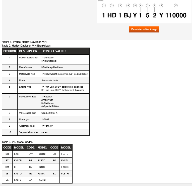

*** = digits 5,6 and 7, and on a 2002 injected Fatboy, would be "B X B".
On an injected Heritage, they would be "B W B".
The last six of the vin should also match the last six stamped into the left engine case, just above the primary.

2002 FLSTCI 2002 HERITAGE SOFTAIL CLASSIC (FLSTCI)
