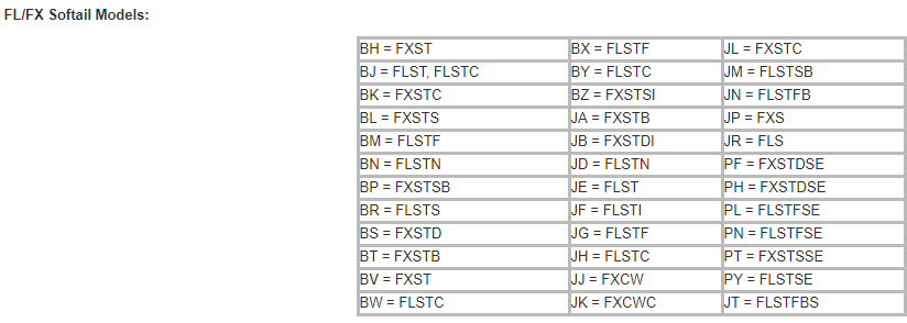

Old Jul 10, 2018 | 01:22 PM

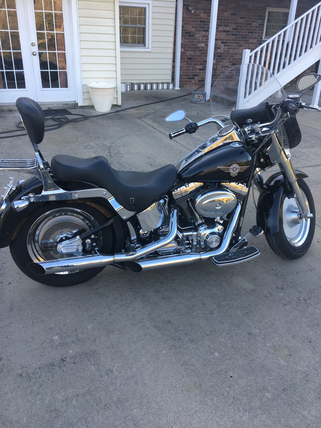

Post pics, we can tell whats going on. Remove the bags and put a stock front fatboy wheel on it and it looks like a fatboy.

Old Jul 10, 2018 | 08:23 PM

Originally Posted by Veekness
Hmmm...first post...improbable story...fishing for trout?
We'll see.
Looks like I'm wrong...excellent!

I know I am new here but at some point everybody was. I actual own a triumph tiger 1050 and wanna elk it. A guy offered me a trade for his Harley. Now I try to figure out if his Harley is the real deal. He said it’s a 2002 Fatboy but according to the VIN it’s a Heritage Softail classic
