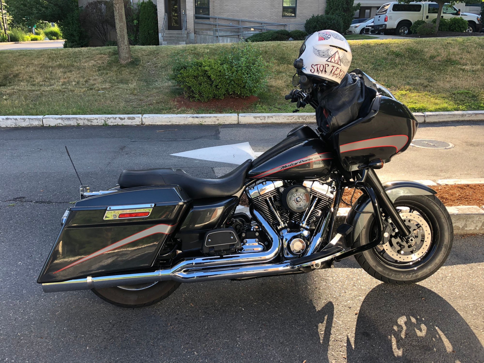

Just got some 13" JRI shocks, 25nm springs. Took some measurements and just want to make sure I'm on the right track. I bought them secondhand so didn't get any paperwork with them for set up.
I weigh 180. Probably 10 pounds in my bags and 50% riding with a 120lb passenger.
With the bike up on a lift I got 280mm or 11"
With the bike weight only, I got 254mm or 10" (26mm or 1" of static sag)
With me sitting on the bike, bags off, I got 241mm or 9.5" (an additional 13mm or 0.5" sag)
From bike up on lift to me sitting the difference is 38mm or 1.5".
I'm guessing, but it looks to me like the difference is too great with just the bike weight on, and not enough from bike weight to adding me. If that makes sense.
Should I lighten up the preload or????
It felt good as is on a 300 mile ride, but I want to make sure I'm getting the most out of it. Thanks!

Bike is a 2008 road glide if that makes a difference.
I know I’ll have to make some sacrifices considering im 50/50 with an extra 120lbs or not but I still want them working to their potential.
