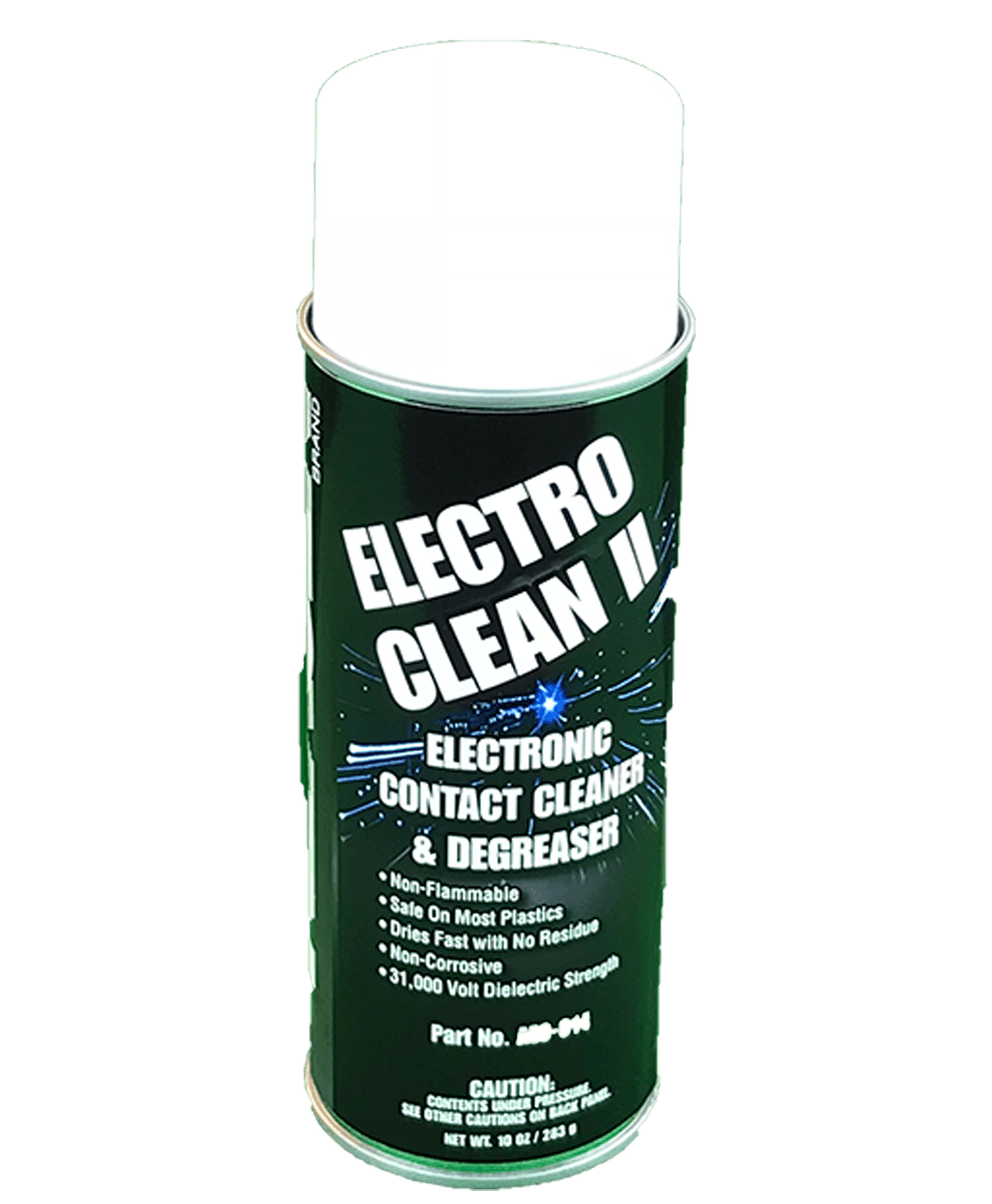

Just my 2 cents but I figure Electroclean should work pretty good and not harm the sensor or the plastic parts of the TMAP sensor.
