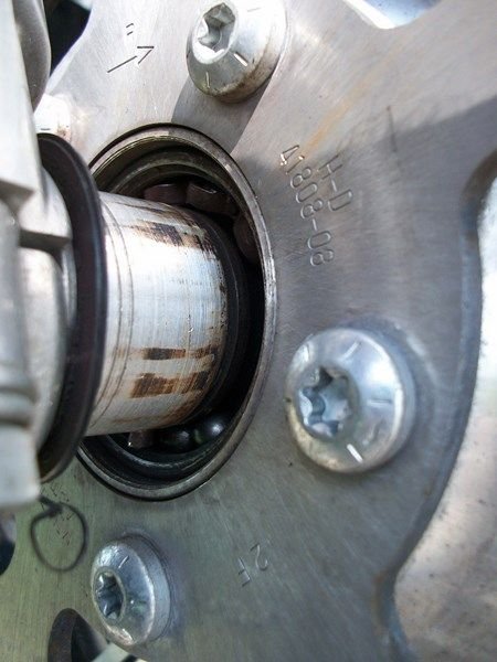

When off the ground turn front wheel if the bearing is going you will hear it. Also look for rust lines running down from the bearing. Extreme case shown here seal is pulled back
