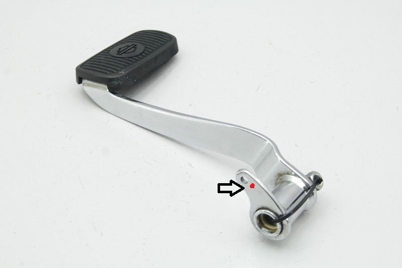

on my RK i had installed a extended peddle and still was not happy with it, i has enough room to drill a hole in a location that lowered the peddle a little once the pin was installed. the location i drilled was behind the stock pin location (if looking at in installed on the bike)
i was very pleased with it after i modded the pin location it was a more natural feel for me not so cramped and since my foot was not so high i had more control of the back brake

i dont have a pic of the one i did but this was pretty much as simple as it gets
the pedal pin moves in an ark so the hole position being a touch lower didnt not affect any thing
i marked in the pic the area i drilled the hole to lower the pedal height
