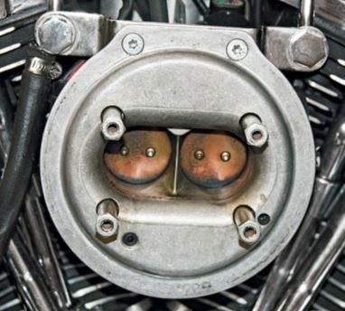

Quick and easy way is pull off your a/c cover and look at the intake throat. Delphi's are round shaped and MM's are rectangular-ish. Here's a pic of the MM.

Delphi has a single throat, MM has two

Thanks for all the replies fellas ...
Originally Posted by Tired
Quick and easy way is pull off your a/c cover and look at the intake throat. Delphi's are round shaped and MM's are rectangular.
Aha ... I'll check that out. Thanks!
