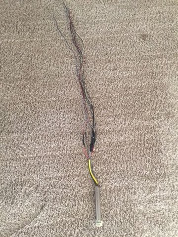

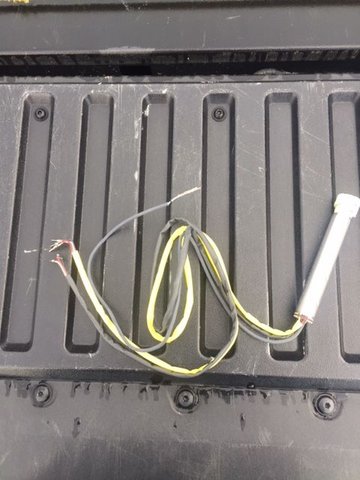

Folks I was WRONG! The top picture is the old TBW that I had to cut green connector off the color coded wire to solder into the red, white and black wires in the black and yellow sheath. Now the bottom picture is the New TBW aka SE TBW, the only difference is the New one has No green connectors and you don't have to use color coded wire with the new one. The new TBW wires the red, white, black in yellow and black sheath is the same length as the old wires, Total length from tip of New TBW is 41" and that is the same length has the old one. The new one just put it through you new bars put connector on the wires and plug to the connector under fairing. So if any one needs another TBW I am putting it in the classifieds.
