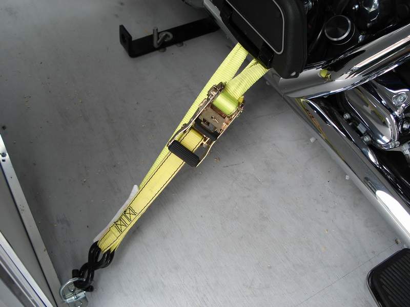

Ideally, proper tie down points should be at a 45 degree angle from the bike to the floor. This means that your placement of your floor latch should be the same distance out from the bike as the distance from the floor directly below your bike tie off point, up to your tie off point on the bike. DO NOT TIE OFF TO YOU HANDLE BARS, IT'S TROUBLE WAITING TO HAPPEN. That said, I tie off like this with all pressure pulling forward into my wheel chock:
Attached Thumbnails  TIE DOWN SETUP IN TRAILER-left-front-1.jpg    TIE DOWN SETUP IN TRAILER-right-front-2.jpg    TIE DOWN SETUP IN TRAILER-right-front-3.jpg    TIE DOWN SETUP IN TRAILER-right-passenger-4.jpg    TIE DOWN SETUP IN TRAILER-right-passenger-5.jpg

tooch69, follow soos,s pictures and you cant go wrong. Mine is set up just like that, and I drive fast and hard. My ultra has never offered to move. I have found with mine, when loading, I place a 2x8 about 24 in. long on the floor by the jiffy stand and when I stop I put the board under the jiffy stand to make the bike sit up straighter, so strapping it down, is easier. I dont leave it there. it,s just for convenience. Dan
