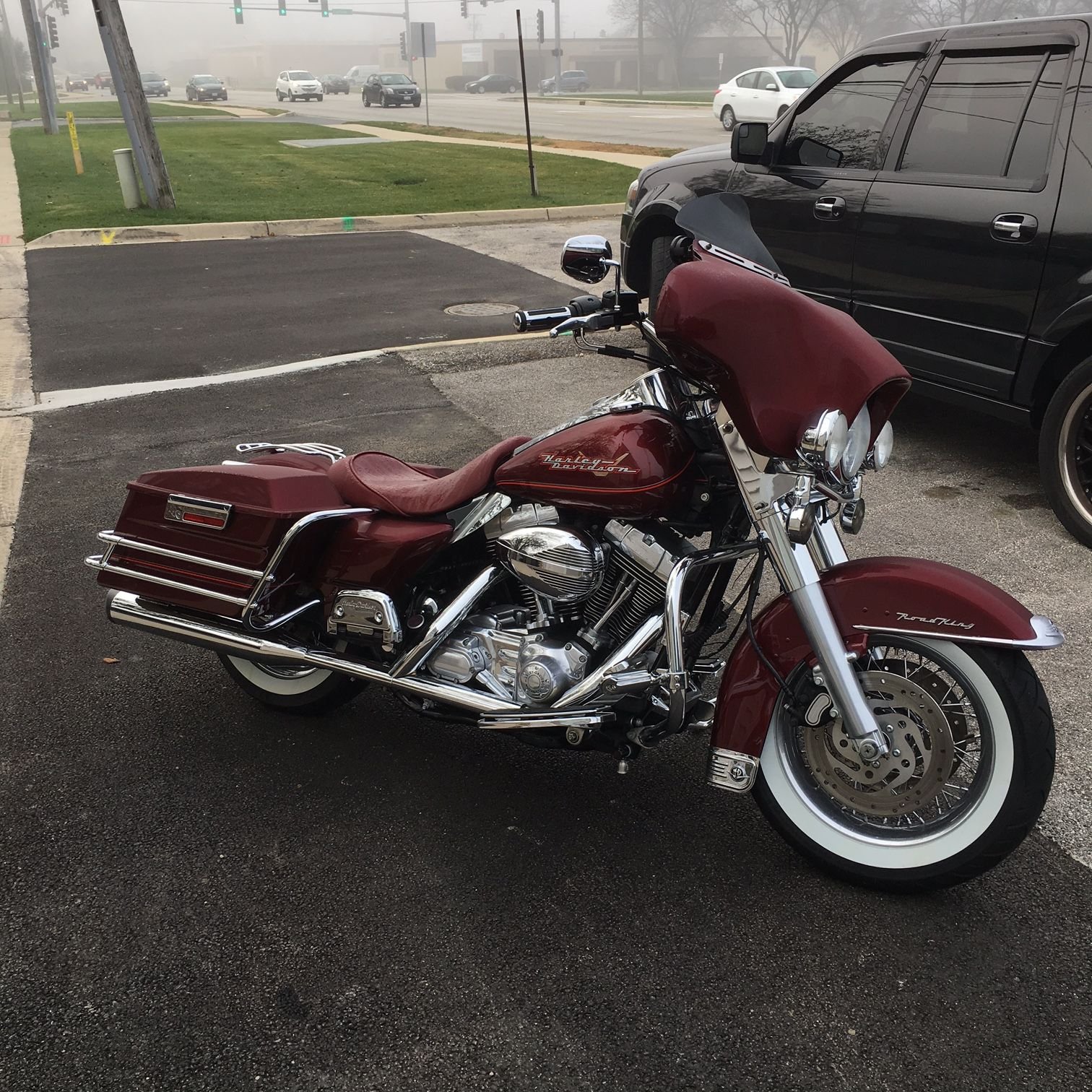

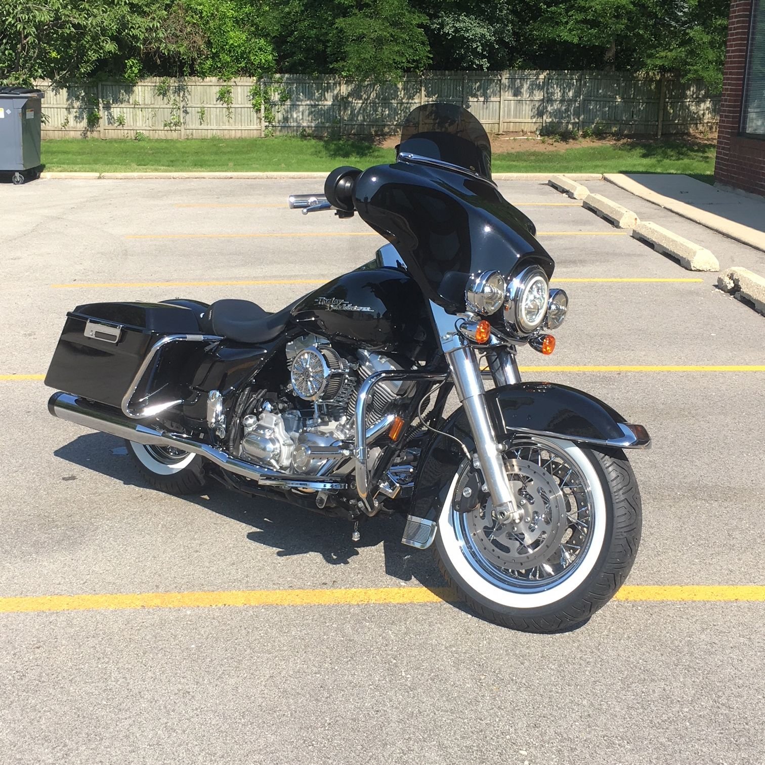

Cajun, i thought my bike was nice riding to before i rode a 17 then getting back on my bike it felt loose and sloppy so much of a difference i was ready to trade in but figured id try to update my suspension before i do since i like my bike so much, had i not rode that 17 id probably still think mine was a good riding bike, im not one to throw money on something just cause Mr, Jones said i must have it. i work to hard for my $$$ im not out to impress any one or make any one do as i do i was just sharing what i done and how it improved on my bike, try to fine as new as you can take it for a spin like to know if you feel like i felt after the test ride? in just a few blocks i could tell a huge improvement that 17 was over mine
also i can tell you the 08 rides better then the 02 RK i had before it, this one is an EG but i had the fairing on my RK so the bikes are pretty close to each other
you have a couple years on me young man im 45 240lb
02 RK 19k miles (when i sold it)
08 EG 21k miles changed up a little (better riding then the RK)
