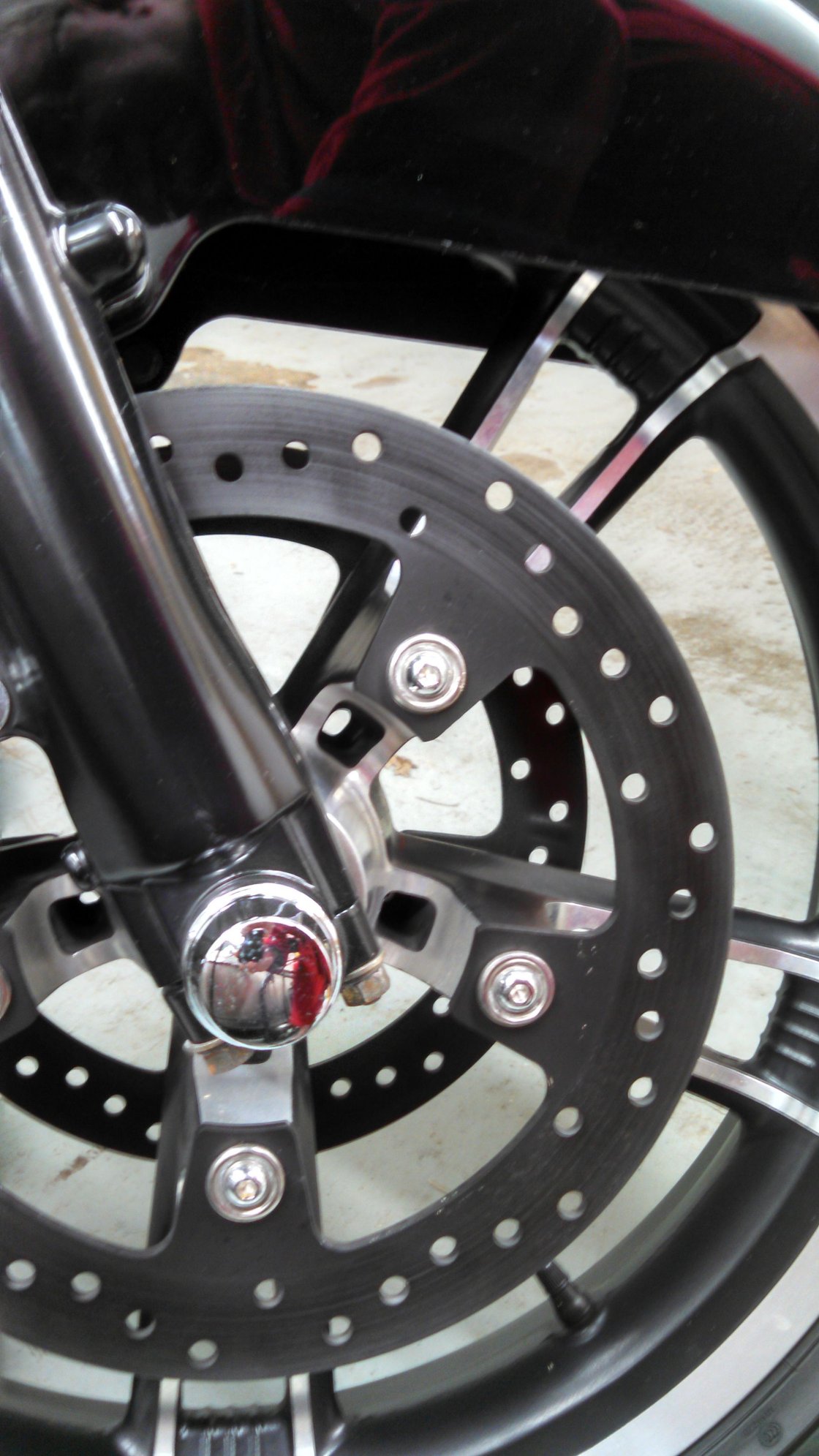

It brakes just fine and I have made a few unwanted panic stops. The high heat ceramic coating is very durable for being only 1 mil .001" thick and appears to have held up well after 6k miles. It's just another option to powder coat and you could elect not to do the pad area as I did. I just took this picture this am.

Actually, that doesn't look too bad. Not any worse than my chrome that has about 10k mi.
