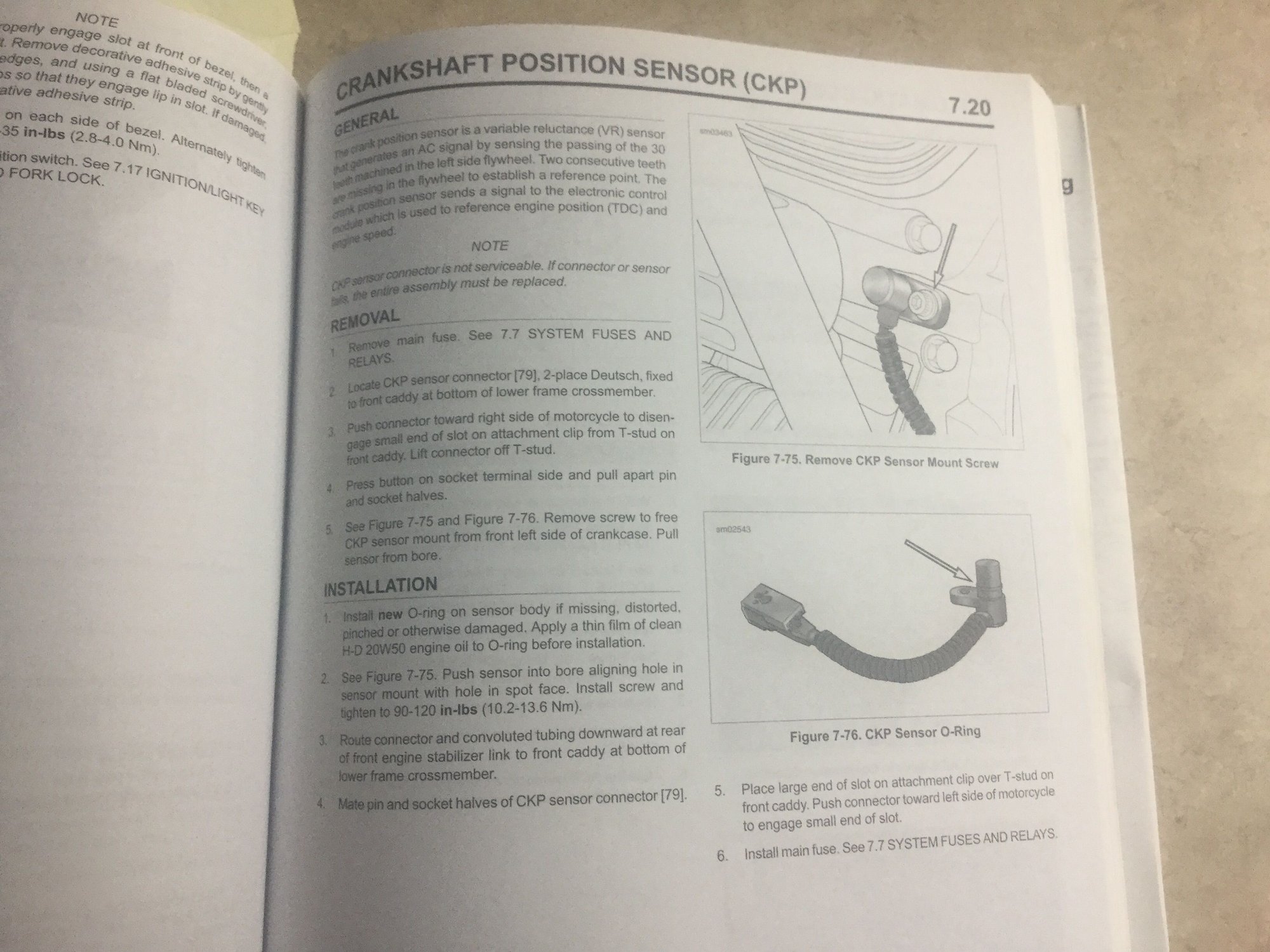

When you have ignition on then turn the stop switch to run the system relay energizes and the fuel pump will run for 2 seconds. If there is no input pulse from the CKP, Crank Shaft Position Sensor, the ECM removes the ground from the system relay coil. As soon as you start to crank the ECM see the signal from the CKP and once again provides a ground for the System relay coil and the pump comes back on. You could pull the connector on the CKP and check to see if you have continuity, you can put the meter on AC And check to see if AC Voltage is present. Unbolt the sensor and see how it looks. Each time you turn the ign. off you have to wait 10 seconds before the ECM will energize the System relay again.

Old Sep 9, 2018 | 08:02 PM
Vernal's Avatar
Vernal
Joined: Apr 2013
Posts: 7,682
Likes: 8,414
From: Utah
