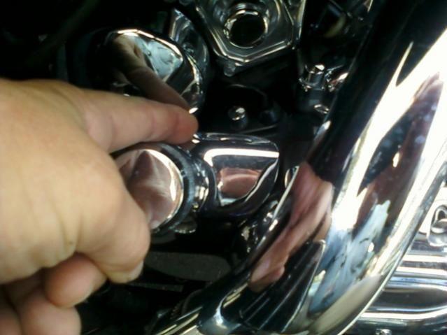

Ok thank you. I look into it. Where is the vss location at?

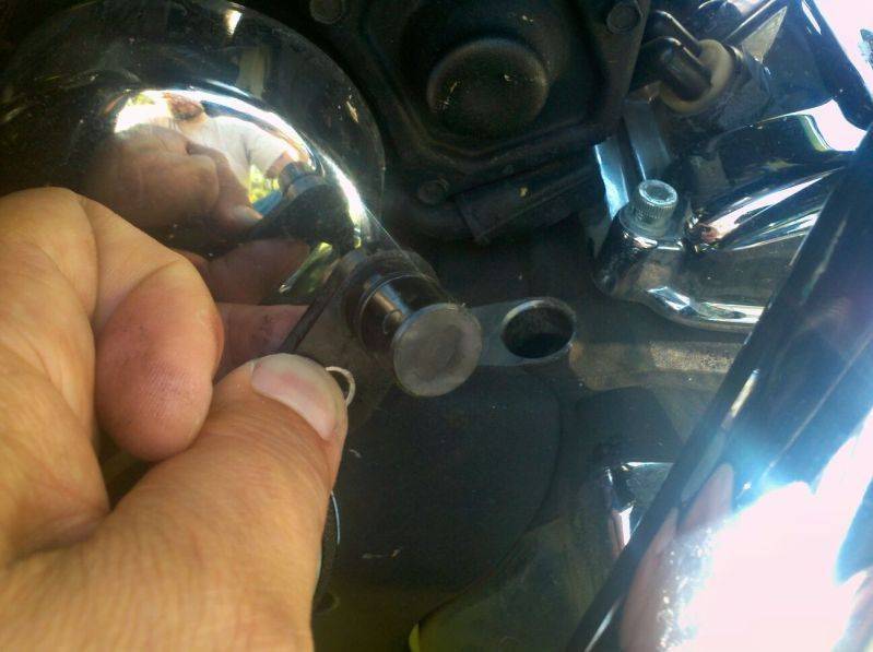

Sep 13, 2018 | 05:29 AM
I pulled these pics from another thread and although the location is slightly different on some bikes, its somewhere close to the starter. I had a little bit of a hassle getting to mine on my 03 King due to how close it was to the starter. It was tough to get it fed through the tight spot it was located in but it may be different on yours.
There will definitely be some metal on it when you pull it off so don't be surprised. As long as its not a lot its fine. Wipe it off and reinstall or replace it altogether.
