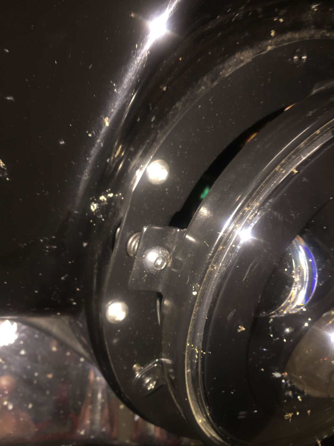

From: Slocomb, Al
Default Headlight
heres adjustment screws
Old Sep 17, 2018 | 09:21 PM
DaleMc0622's Avatar
DaleMc0622
Joined: Nov 2013
Posts: 475
Likes: 55
From: SC
Yep, like mine. Like I said, if you only use a longer screw the spring won't be tight enough to keep it tight. I used a small chrome spacer and chrome screws, again, overkill because with the trim ring on you don't see it. If you use spacers on all three you are defeating the purpose of the one on top, don'task me how I know that, lol. Good luck.
