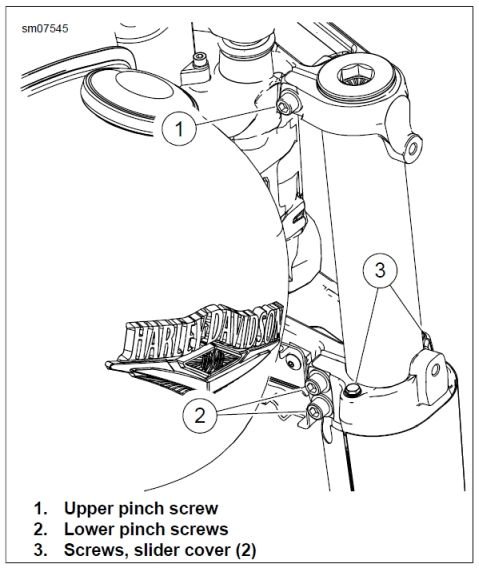

You got it. Once the fork tube is out of the way, there are 2 screws attaching the slider cover to the lower triple tree.

AHHH I see. I couldn't see these screws at first. Makes sense now. Sure wish I didn't have to remove the forks to do all this. BUT, it should be worth it in the end...

It's not that bad if you take your time. I did it to my Road King, which requires removing the light bar and whole headlight nacelle. Do yourself a favor and invest in a service manual. There are critical torque specs for the pinch bolts on the triple tree and other critical specs related to setting the forks in the right position in the trees.
