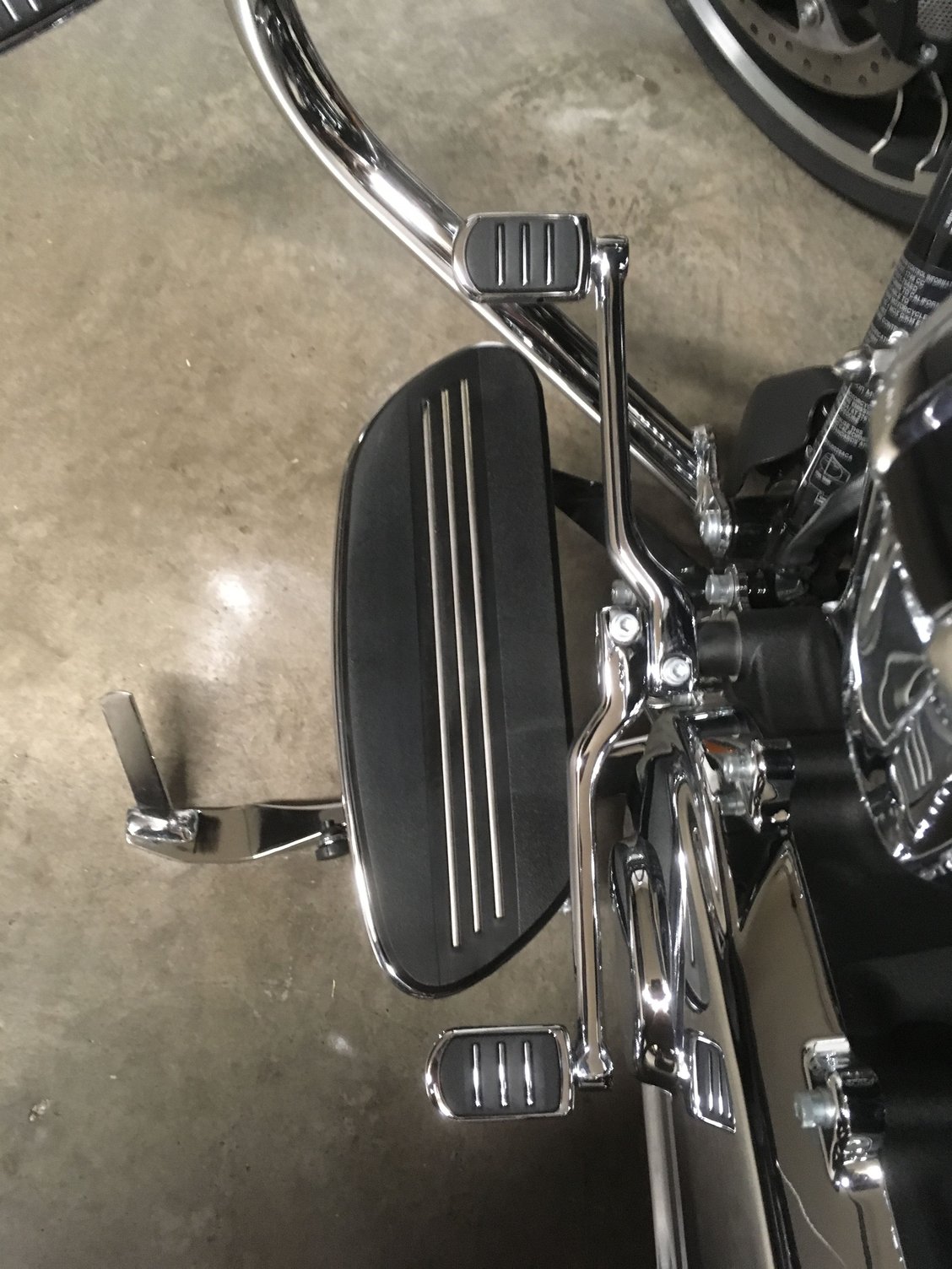

Hi anyone tried the streamliner shifter pegs, wondering if there more comfortable , They look good, And are the stock pegs torqed down pretty good. do you need to heat to get off, thanks Danny

Stock pegs are pretty easy to remove, they have a bit of lock tite on the threads, but nothing you will need heat for.

15 minute job to R&R stock peg. Have never even thought about "comfort" with regard to a shifter peg. If it attaches to the lever at a 90 degree angle and can catch your boot...done. Unless you're riding in slippers or flip-flops (say no)...ha.

I put them on my old 2011 so everything would match(streamliner pegs, floorboards, grips etc) easy to do. As for comfort couldn't tell any difference through my boot.

Just installed them, piece o' cake. No heat needed to remove old ones. I used a small bore brush to clean the old loc-tite out of the threads.
