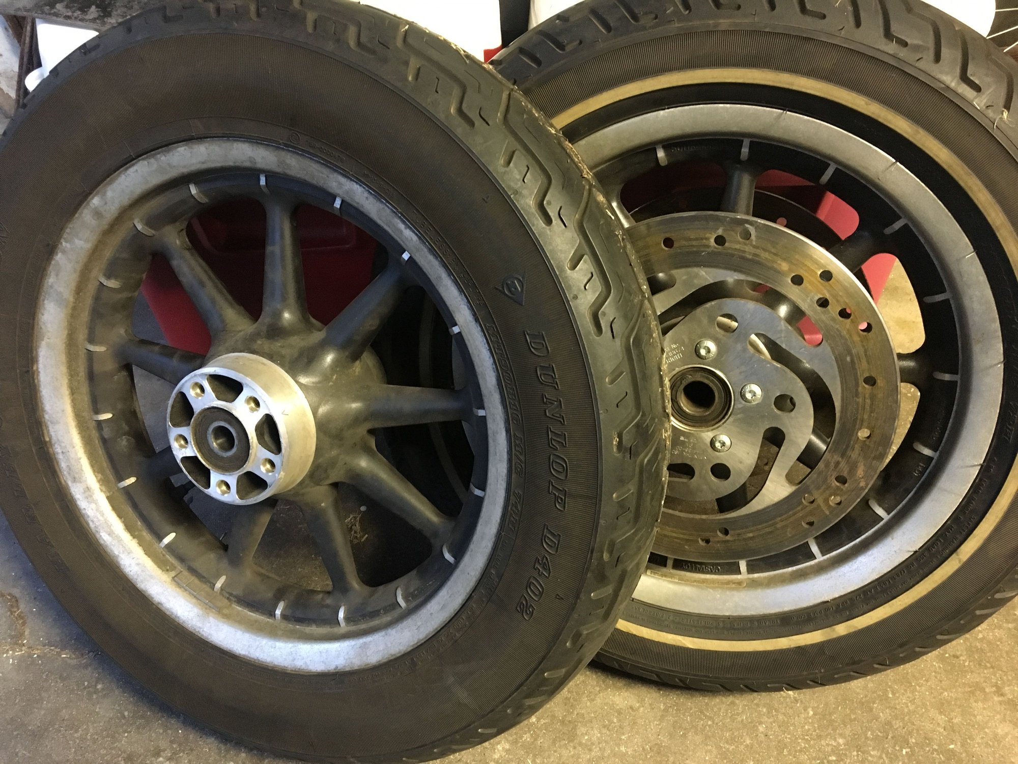

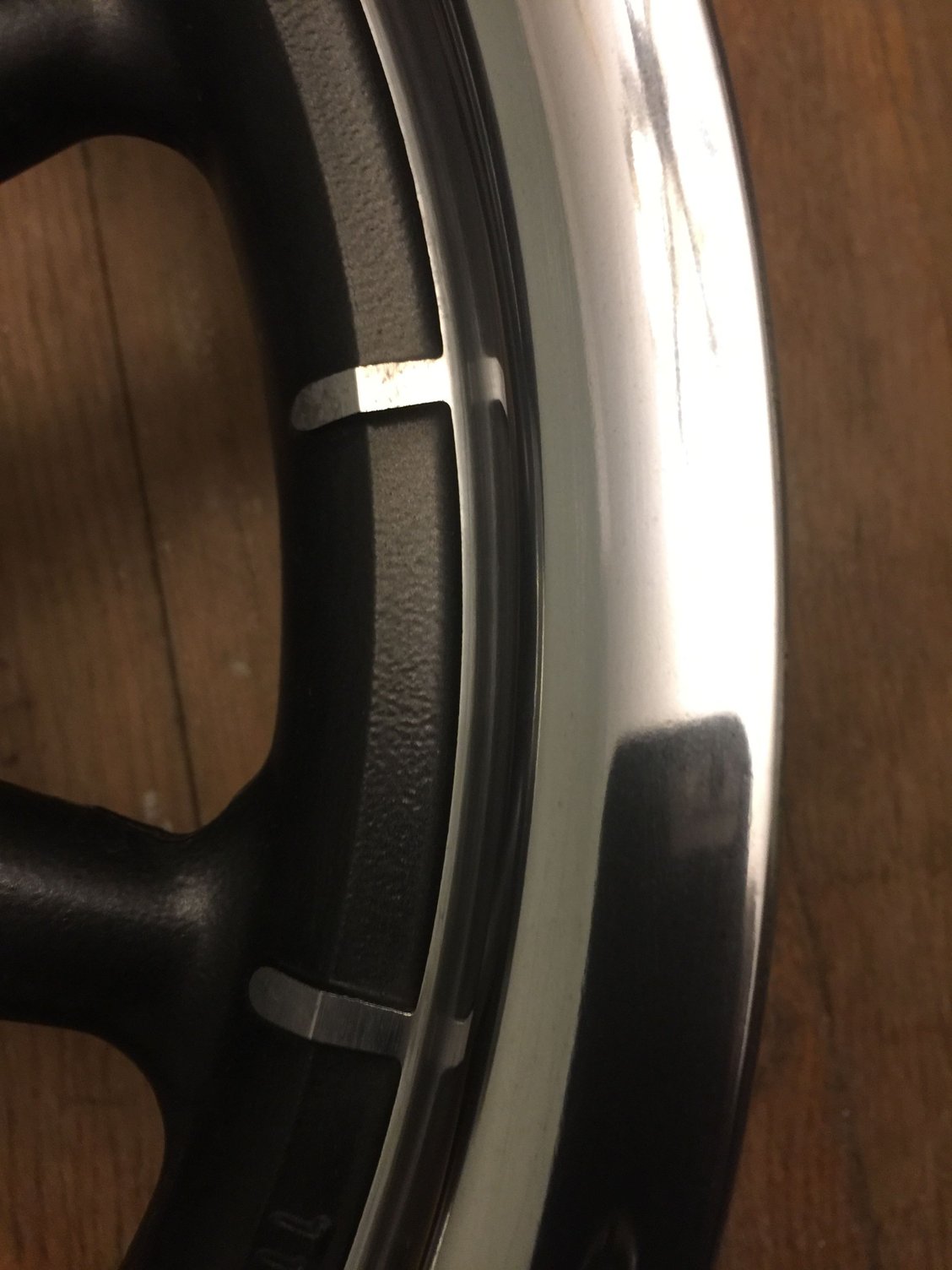

Default Progress made :)
I am happy to report that some progress has been made.
I am not real happy yet, I think I will go to 800-1000 grit paper, but the shine is on!

They look good, you should do the center hubs too while the rims are of the bike.

Thanks. I will, I am in the trial and error stage. The hubs will take quite a lot more sanding, as they are milled a bit rougher.
