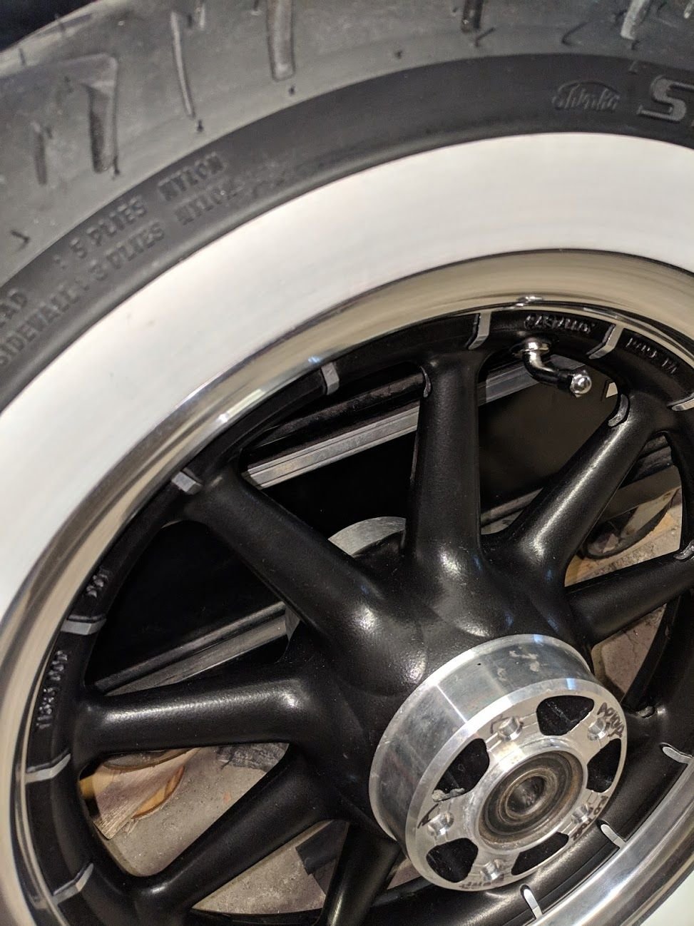

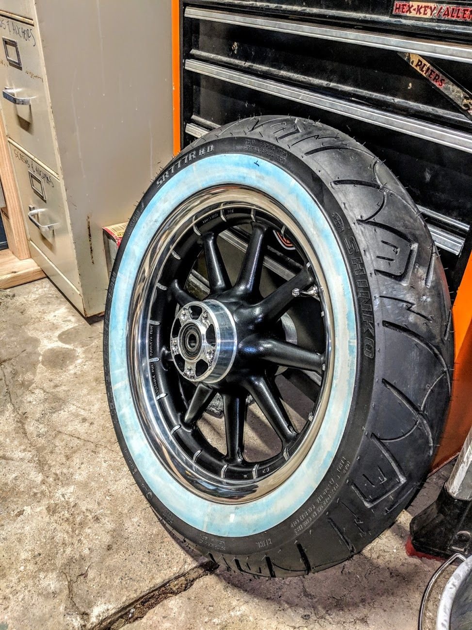

Quick update. I have been busy with everything else in life, and winter has been giving me a reason to not expedite this project of mine. Now we are closer to spring (yay) and its time to pick up the pace. The rear wheel is done, new tire installed and I will start on the front wheel tomorrow. As it has been said above, a lot of elbow grease and patience.
I still think I made the right decision by not chrome plating the wheel. I have asked others with the chrome wheels with dual front rotors and they all say they are a major PITA to clean. I am thinking I'll make up the difference by replacing the rotors with polished ones and the forks with chrome plated sliders.
I am still trying to remove the blue stuff off the white walls, no fun...
