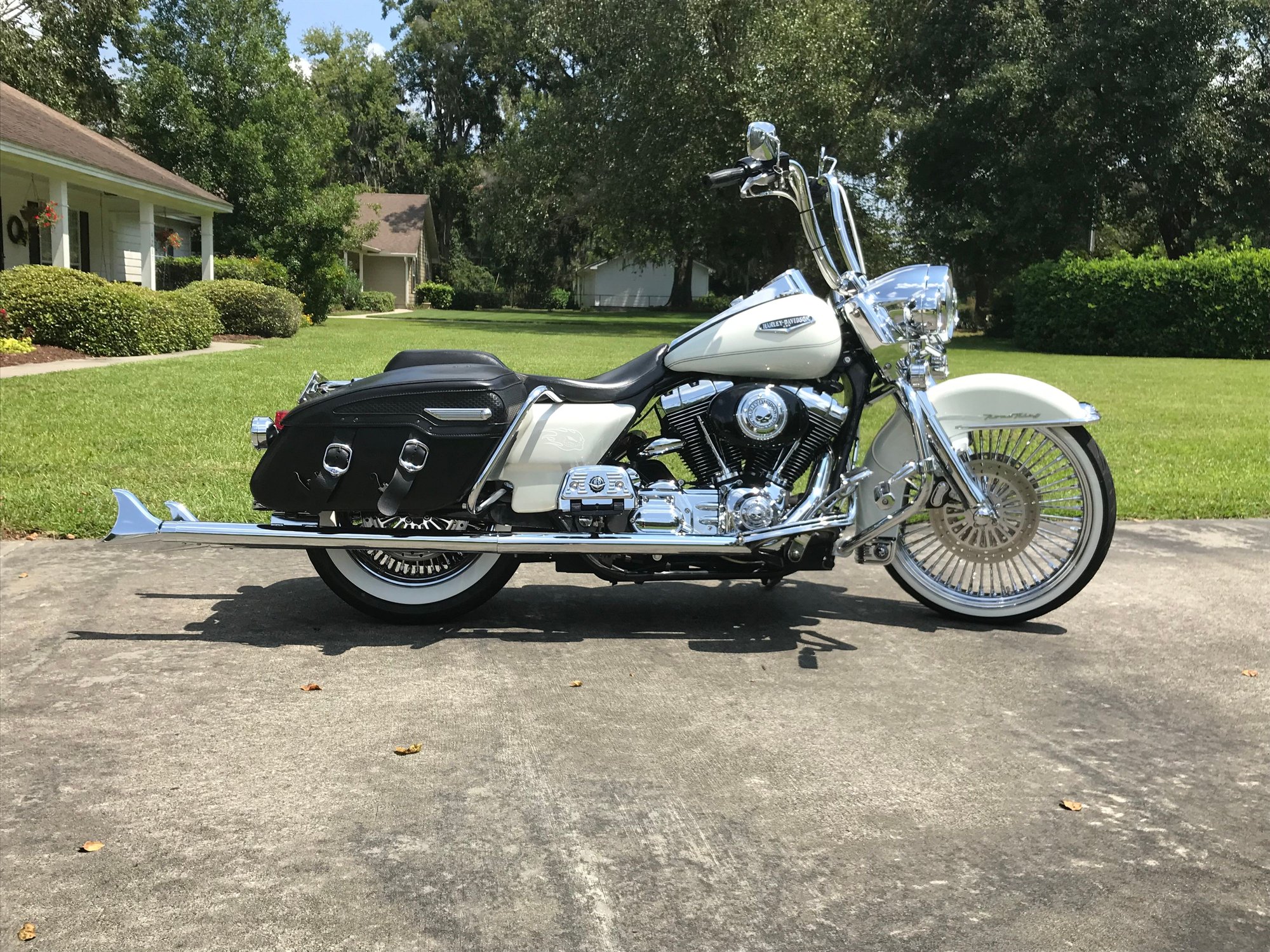

With a bike that looks as good as that you just have to pamper it!
